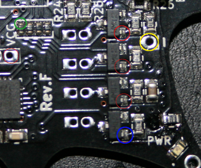

Hi! I have done extensive testing with a friend who is competent in electronics, and gone through the posts you suggested. The motors all work on their own, but the 4th does not work on the board...
I have applied VCC to the 4th motor and that makes it spin. But it seems like on bootup the MOSFET is not recieving any signal. We measured the voltage profile on the gate (with oscilloscope) comparing the M3 and M4 positions. M3 produced a large stereotyped response while M4 gave nothing. Since the gate does work (as checked by shorting VCC to it) it seems there is some other more deep seeded problem with the board...
What do you think? Also, here are some pictures of the set up to test.

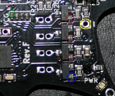

Re: M4 doesn't work
Then it is only the signal path left to check. Can you measure, with an ohm-meter, the resistance between the blue-yellow circles and between the blue-green circles in the picture. The blue-yellow should measure 10k ohms and the blue-green should measure 100ohm.

Re: M4 doesn't work
Hi Tobias,
Apologies for the late reply. Things have been busy and I haven't had too much time for this project lately. I did check what you suggested. The blue-yellow did measure 10 kOhms, but was unable to get any resistance between the blue-green.

Re: M4 doesn't work
Then we are a bit closer to finding the problem. Something is broken between the resistor with the green circle and the transistor leg, blue circle. First can you measure the resistance of the small resistor with the green circle? It should read close to 100 ohm. Then try to inspect the trace going from the resistor to the transistor (green to blue circle) for a broken trace.
