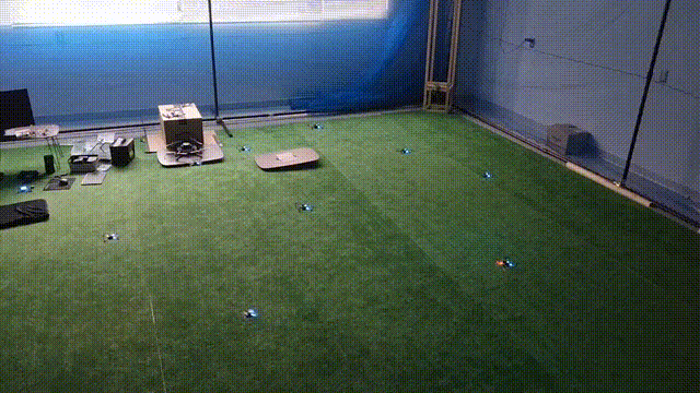

We set it up and created simple script using scf.cf.high_level_commander.go_to () based on synchronizedSequence.py in order to do swarming.
The result of that looks stable but one of the crazyflie suddenly loses balance and flipped as I attached gif.
Could you tell me the typical reason of this?
I'm debugging it now but not clear so far.

It is very hard to say what happened in this case but this type of failure is often caused by outliers. If you also use the mellinger controller it is also very sensitive to errors in the estimated position.
Is the problem repeatable or was it a one off?

It's repeatable when we use synchronizedSequence.py.
but when I tried autonomous_sequence_high_level.py, there is no error so far.

My guess is that it is that particular area that is problematic. It could be that the coverage from the base stations is poor (I can not see where they are located) or that there is a reflection in some object.
You could try to write a script that flies through that area to see what happens?
