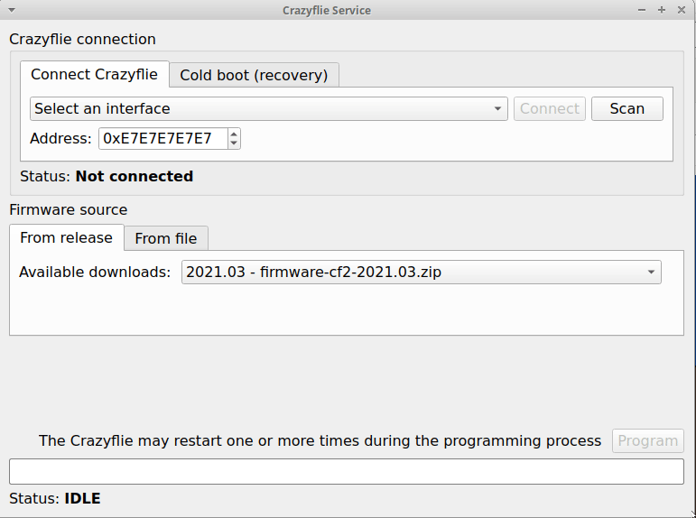

I am using the PA radio and am having the same issue as the original post. Here are the steps I follow and the issues I run into:
  1. Open Command Prompt and type cfclient to open.
  2. In upper menu bar, click "Connect ---> Bootloader" to open the Crazyflie Service menu.
  3. Under the "Crazyflie connection" section in the "Connect Crazyflie" tab, click "Scan" to find my Crazyflie and then "Connect" once it has found my Crazyflie to connect in firmware mode.
  4. Under the "Firmware source" section in the "From release" tab, select the most recent release from the "Available downloads" dropdown menu.
  5. Select "Program" at the bottom right of the window.
Following these steps has resulted in two different issues so far:
  • Either the status changes almost immediately to "Not connected".
  • Or the firmware download is endlessly "Fetching..." (although this only happened once).
I also tried following the same steps on the Virtual Machine and the same "Not connected" issue occurs. I did attempt to reinstall the Crazyflie Python library as GIdaurte did but that did not resolve the issue for me.

Another individual I am working with found a resolution to the original issue of the Crazyflie disconnecting when attempting to flash the most updated firmware release. In a Command Prompt, we ran the following commands:
git clone https://github.com/bitcraze/crazyflie-lib-python.git
cd crazyflie-lib-python
pip install -e .
Personally, I needed to change the last command to
pip3 install -e .
While this solved the original issue of not being able to flash the Crazyflie with the most recent firmware release, I still have an issue with the "Cold boot (recovery)" option. Prior to the above fix, when I attempted to perform a "Cold boot (recovery)" in the client, the status would say "start_bootloader() got an unexpected keyword argument 'cf'". Now when I attempt to perform a "Cold boot (recovery)", the status just says "Flashing" and does not change. The progress bar at the bottom of the window also does not progress. I'm not sure what is causing this issue now, but this fix is a lot less urgent now that the original issue has been resolved. However, if you have any suggestions for this new obstacle I would be happy to try them out as this could become more urgent if I ever do need to recover my Crazyflie from a failure state.
