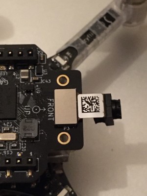

I have replaced the camera before on the AIdeck 1.0 and for me it worked, and also on the previous prototype we had a grayscale camera, so we can say with a good certainty that the grayscale camera should work on the AIdeck 1.0.
Maybe the new camera is not connecting properly, could you send a close up of the connection without the mount?

Re: New camera issues
hi
here is the camera mounted without the cover. Is the notched wheel around the lens used for any purpose? I unplugged and re-plugged the camera a couple of times to make sure is in porperly. Can i test the camera with the cover off?
regards
rodrigo
regards
rodrigo

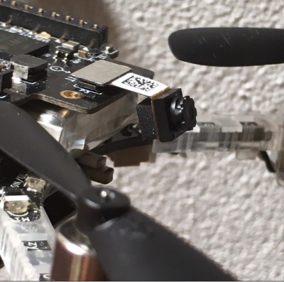

1pi
- Posts: 49
- Joined: Mon Nov 23, 2020 1:28 am
hi
this photo may be clearer
- Posts: 1050
Thanks for the picture!
The connection seems good, but I'm worried about the condition of the flex PCB. It looks sharply bent and snapped, and I'm afraid that the flexpcb now is broken and the connection between the camera and the gap8 are disconnected...
Do you have another grayscale camera which you can try out?
Hi
I don’t know how that could have happened, because I was extremely careful when I installed it. No I don’t have another grayscale camera I got this one free of charge from bitcraze as they offered it to people who have the version 1.0 of the ai deck. Well I don’t know what to do, could it have been already damaged when I received it?
I feel terrible asking for a replacement as this one was free of charge.
Regards
Rodrigo
Regards
Rodrigo
