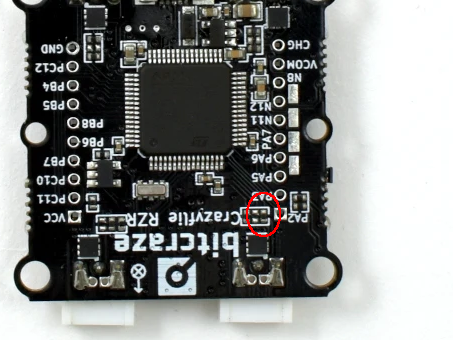

Re: Crazyflie Bolt, one of the motor outputs is not working.
Could the signal have been shorted to the 12V? There is a 100ohm resistor to protect the output from shorting but for how long is hard to say. I did try and short it to 12.4V for a couple off seconds with no damage, but it was pulling ~50mA and I'm not sure how long it would last. Is the resistor still there and well soldered?

I am not sure how the signal would have been shorted to the 12V? Yes the resistor is still there and well soldered. From the picture, it is hard to tell which resistor you circled but the two outer slots of the area you circled have resistors while the middle slot does not.

The connector contains VBAT - SIGNAL - GND so the signal can be accidentally shorted to either of these. Shorting to GND shouldn't be any problem but shorting to VBAT could be destructive.
I think the GPIO is broke on the STM32F405. Please send us an email to support(at)bitcraze.io and we will help you out.
