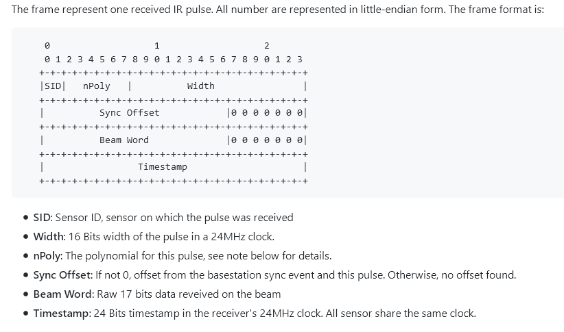

now Uart is alive and it is sending a bunch of data out of it. Is there anyone maybe that can assist anyhow in order to clarify what those numbers are? They are captured and are like in manual is written.
I have partially used your code to capture 12 bits..
Thanks for your answer,
Bostjan Nagode

That you had to send 0x00 is normal: the deck starts in bootloader mode and 0x00 is the command to start the firmware. The bootloader is documented there: https://www.bitcraze.io/documentation/r ... -protocol/
To set the leds it should be enough to send "0x01 <LED_STAUS>" over the UART. For example sending "0x01 0x01" should blink the red led slowly.
As for the pulses, the screenshot you took documents what the different values are. The FPGA is acquiring lighthouse pulse timing and, for lighthouse v2, beam-data, identity and beam-time-offset. The meaning of the pulse if documented in many documents on the internet, we have not centralized the information in any of our doc yet. For lighthouse v1 this is a good repos: https://github.com/nairol/LighthouseRed ... issions.md. For lighthouse V2 I explained a bit how it worked in this blog post: https://www.bitcraze.io/2020/02/crazyfl ... thouse-v2/. The code in the Crazyflie should be mostly architecture independent so if can be used to decode the angles.
With both lighthouse V1 and V2 you will end up with a couple of angles per base-station. The crazyflie firmware repos contains some doc on how we use these angles to feed the kalman filter to achieved positioning: https://www.bitcraze.io/documentation/r ... ighthouse/.
