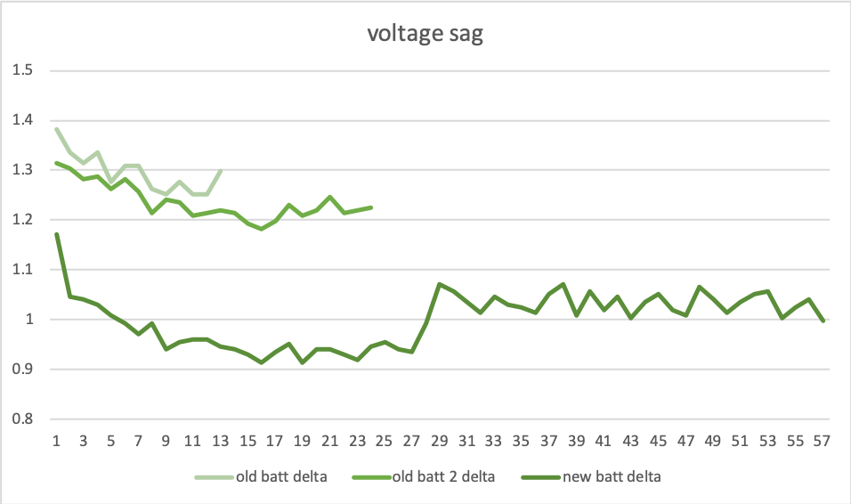

This is not as much as a problem as it is a PSA for anyone experiencing the same kind of phantom bug that I thought I had. After take off with an LH deck, the CF would drift away and crash. All logged raw angles would just repeat themselves even though the lighthouseses were in plain sign of the deck. The LH was working just fine before takeoff.
Problem was (I think!) that I was using really old (standard) batteries, the voltage sag was so great that even though the voltage was being read in the 3.8's before take off, It would drop down to below 2.55 - 2.6v, which seems to be the magic range at which there is some sort partial brown out reset on the LH deck(?)
This is not that big of a problem with new batteries because by the time the voltage sag at launch is getting close to 2.56v the low batterylight is on the CF anyway, so you would replace the battery.

X axis = number of (launches, 1 sec hover, landings) before the error occured

Ok great to hear! I would like to also add my two fixes to reduce the chances of this bug happening.
1) add the cut out voltage in the firmware. the critical sag voltage added in a previous post has been working well. somewhere between 2.65 and 2.7 catches most of the faults.
2) gradual take off of the cf. I was sending setpoints from the commander of (0,0,1) to the cf which I assume made it take off with full throtttle. gradually feeding it z position in smaller and slower increments had reduced the voltage sag and in turn the LH deck brownig out.
