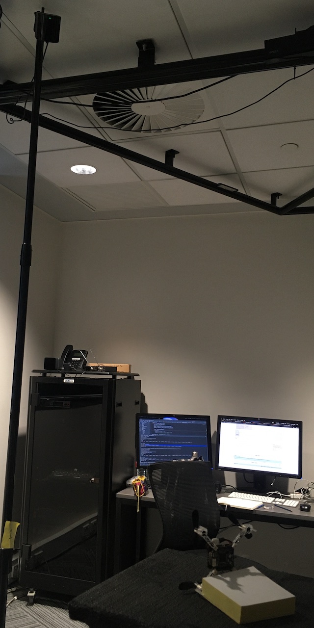

I am looking for some guidance on how to to run >2 V2 lighthouses, some will be mounted on the ceiling looking down. Others will be mounted on the floor looking upwards. (there will be two motorless crazyflies that need to be tracked even when upside down see here: viewtopic.php?f=20&t=4600)
The first part of this question is how to move past 2 base stations. The documentation talks about modifying "PULSE_PROCESSOR_N_BASE_STATIONS in pulse_processor.h ". So I assume after doing this, the 8 step process in the documentation is the same. https://www.bitcraze.io/documentation/r ... etting_up/
with regards to the upwards facing base stations, Is is as simple as running get_bs_geometry.py to get the positional data with the drone upside down? Then inverting these values in some way, before adding them to the positional data retrieved from the drone facing the right way up?
Cheers
Cheers

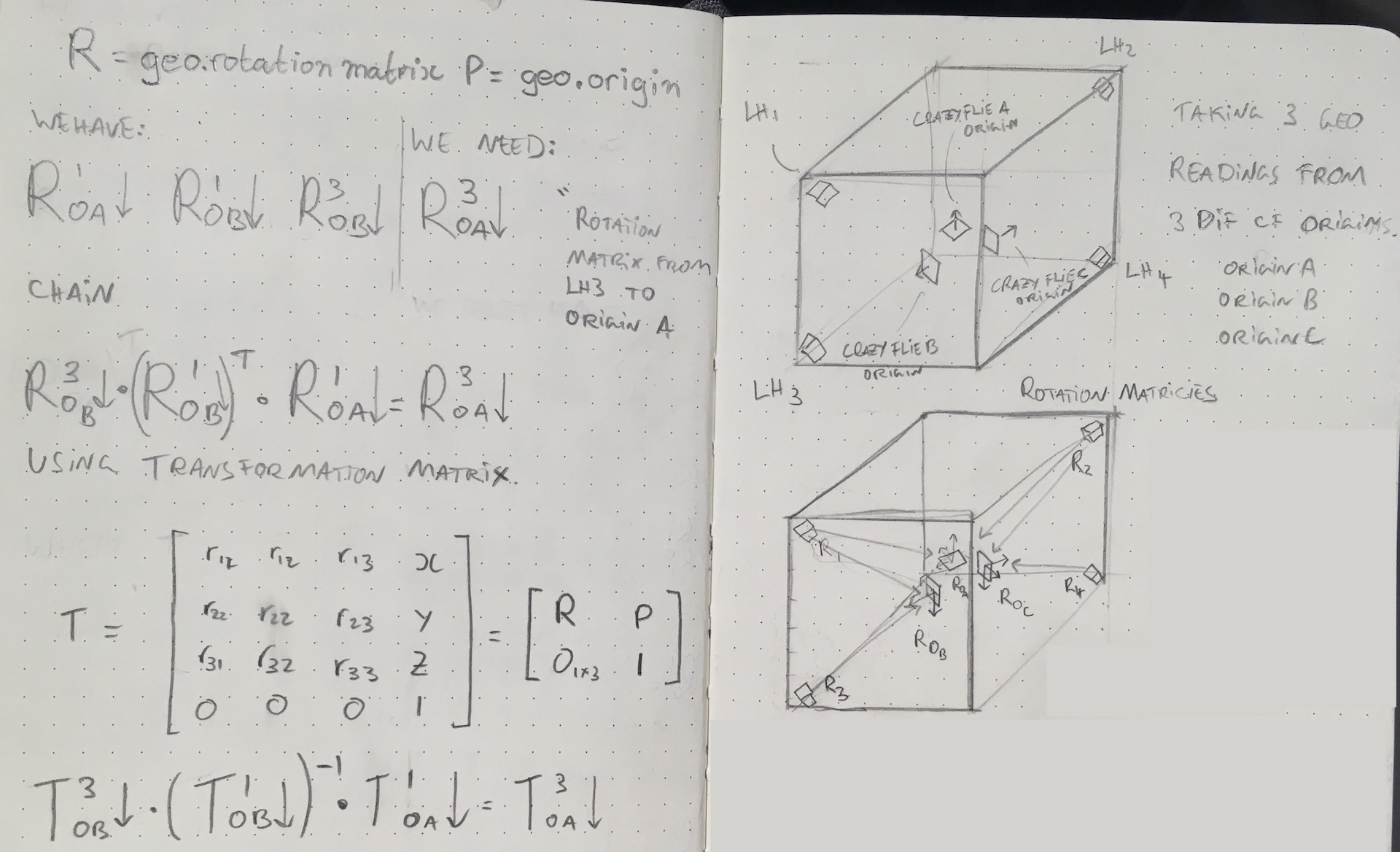

I have been refreshing my knowledge on rotation matricies and wanted to propose a better way to mesh these coordinates together.
If we took three readings from get_bs_geometry.py in three seperate positions. we could chain the reference frames together right? (it has been a long time since I did engineering maths) This would save me the tricky task of making sure the CF is the same position for each measuremnt (as initially suggested)
! am going to look into calculating this tomorrow, but I got some weird results when I took the measurements today with the Cf on it's side. I was getting seemingly inverted Y axis values for geo.origin... the y value should be negative shouldnt it? assumign the right hand rule?

Each CF position is a reference frame and you need to find the transformation of the base station pose from one reference frame to the next one.
You can try this script out, or use is as inspiration.
In your case (the picture) I think i looks like you should get something like (-1, 0, 2). You can find the definition of the coordinate system here https://www.bitcraze.io/documentation/r ... finitions/
Yes, as long as you have readings for (at least) two base stations in each position you can map the pose of a base station from one position to another.If we took three readings from get_bs_geometry.py in three seperate positions. we could chain the reference frames together right? (it has been a long time since I did engineering maths)

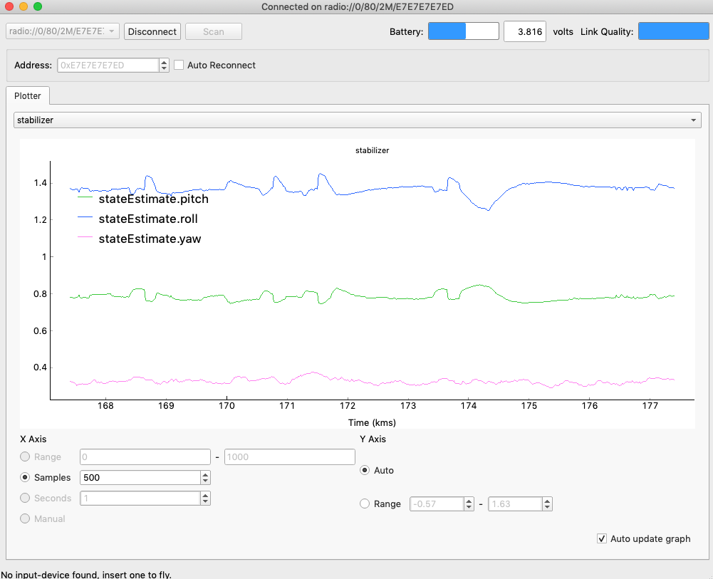

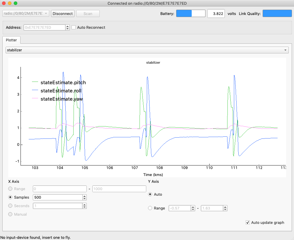

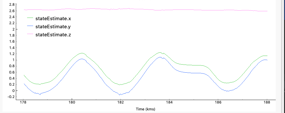

1) Took 4 measurements in various places on the floor with the CF facing upwards, and 4 measurements in various places on a platform 1.2 m high. The script does seem to smooth out a lof of the jumping around I would normally get if I took one 'get_bs_geometry.py' measurement fromt he floor. See below, the plot of the CF just sitting on the floor withoug having taken off. IE the CF flies more smoothly with the multiple measurments. 2) When I took 6 measurements with the Cf on it's side + 2 measurments with the cf facing up, I also got the same kind of stability improvement, but once i flipped the motorless cf 'hand pad' over (to rely on the single BS on the floor facing upwards), the x and y state estimates seem to be tracking the z values. Below, I am moving the drone up and down in the same global x,y but +-1.2 m in the z axis. Can this script handle measurements taken from the CF on it's side? From what I can tell it should be able to. The rotation matricies were multiplied to transform them into the global system. that should take into account any position the CF finds itself in...?
the other thing about this script I dont understand is why {system.R} is not returned at the end... are the rotation matricies not supposed to be used?
Cheers

Hi Kristoffer,
Super exciting to have finally reached some precipice!
I have an engineer friend to help me from this point forward. He wants to know how does the rotor reference frame come into play.
is it something we need consider in this problem?
Cheers
J
Cheers
J
- Posts: 630
Re: Using v2 lighthouses facing upwards
Hi Joe!
No, you should not have to care about the rotor reference frame, only the CF-, global- and base station reference frames.
The output from the estimation script is the base station pose (position + attitude) in the CF reference frame.
In the standard use case the pose of both base stations are estimated at the same time, and thus share the same (CF) reference frame. Further more the CF reference frame (at the point of estimation) is considered to be the same as the global reference frame and defines the global coordinate system.
In your case you will have multiple base station estimates done at different times with different CF reference frames (as the CF has moved around). You will also have to decide where you want to define your global reference frame.
- K
- K
