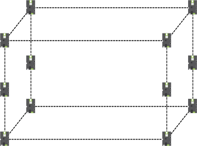

Would it work for installing more anchors for example like this? ofcourse using TDOA3.
or any good ideas?

As long as the Crazyflie is inside the anchor space (the convex hull) I would not expect the std to change a lot depending on the height. If your top anchors are higher than the Crazyflie, the geometry is identical (from an LPS point of view) to flying close to the floor. It is possible that the floor has some influence but if that is the case I would expect the problems to be close to the floor instead.
It looks like you are using a flow deck as well in the video, that would make a difference though, are your measurements done with or without the flow deck?
Your flying space is 8x8 meters, how high up are the top anchors? If they are at around 2-2.5 meters you get a fairly "flat" geometry which does provide little information (mainly in Z) to the estimator. It is possible that adding an anchor in the top-center of the space would help a bit.

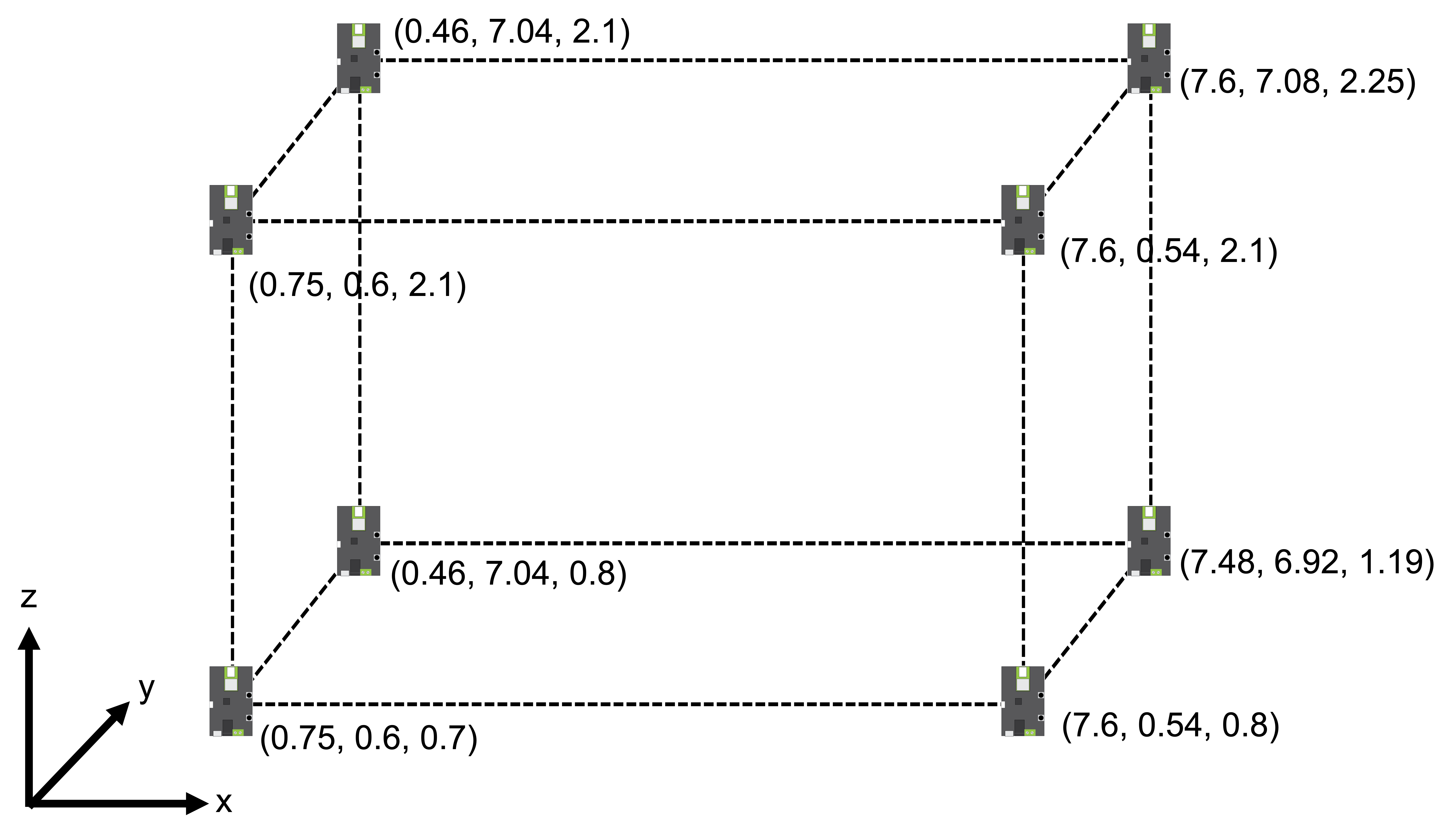

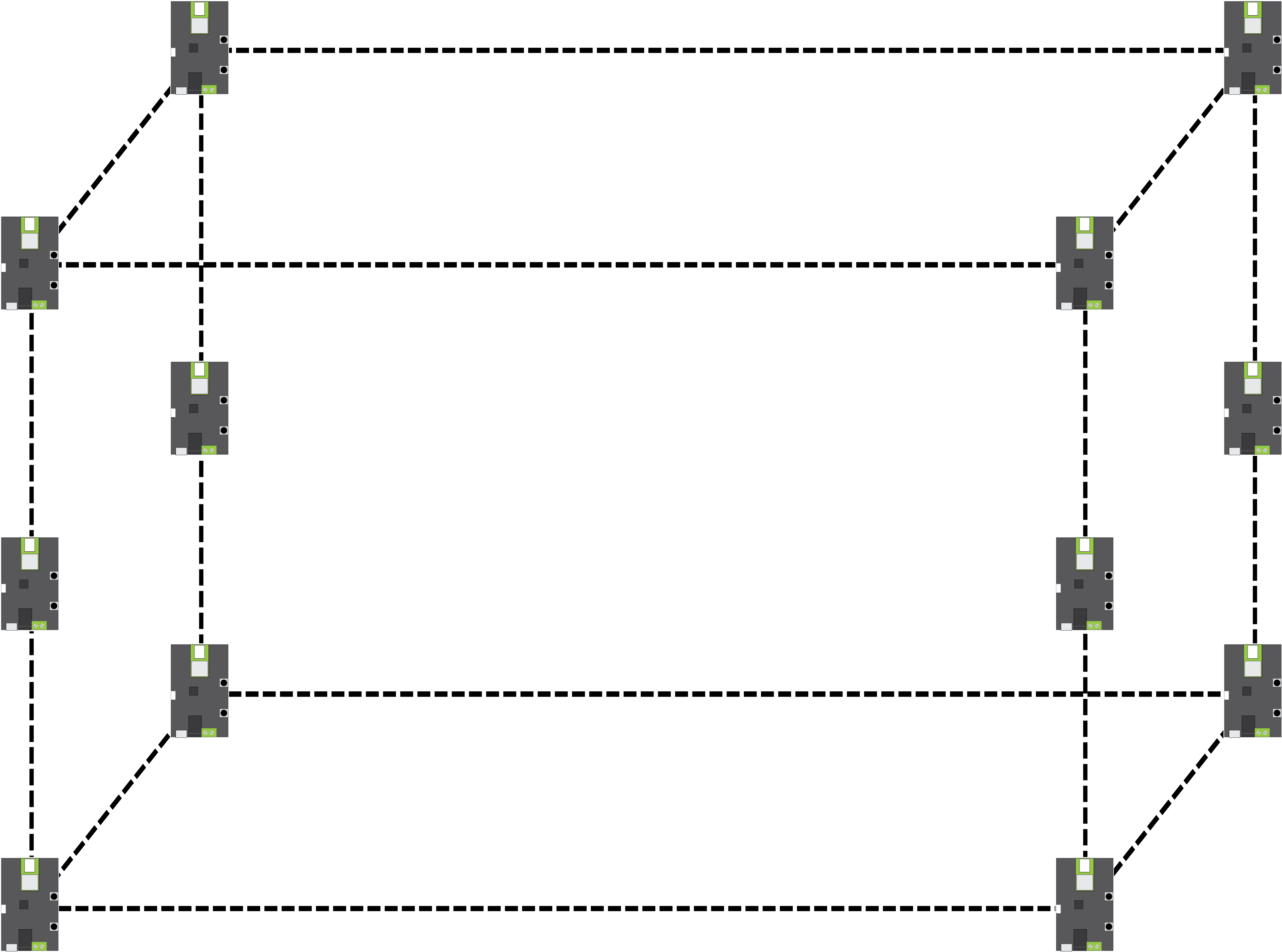

This is the picture of how i settled anchors
below anchors has height of 0.7m~1.19m, and top anchors has height of 2.1m~2.25m.
So flying drone in 1.5m~2m height is in convex hull.
I just increased Tx power and it worked really well wow!
i settled tx power to 30db using set_tx_power.py (https://github.com/bitcraze/lps-node-fi ... x_power.py)
Thanks for the advice!
