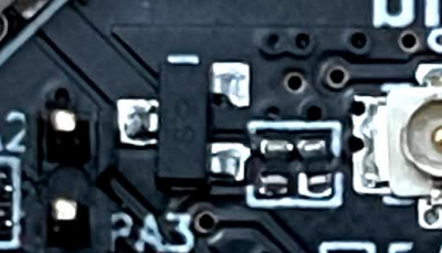

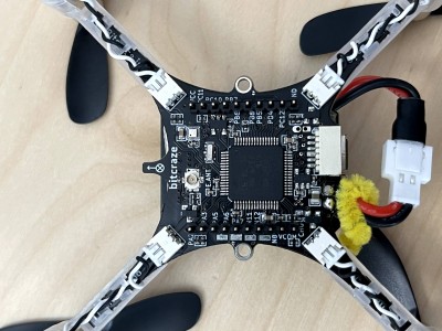

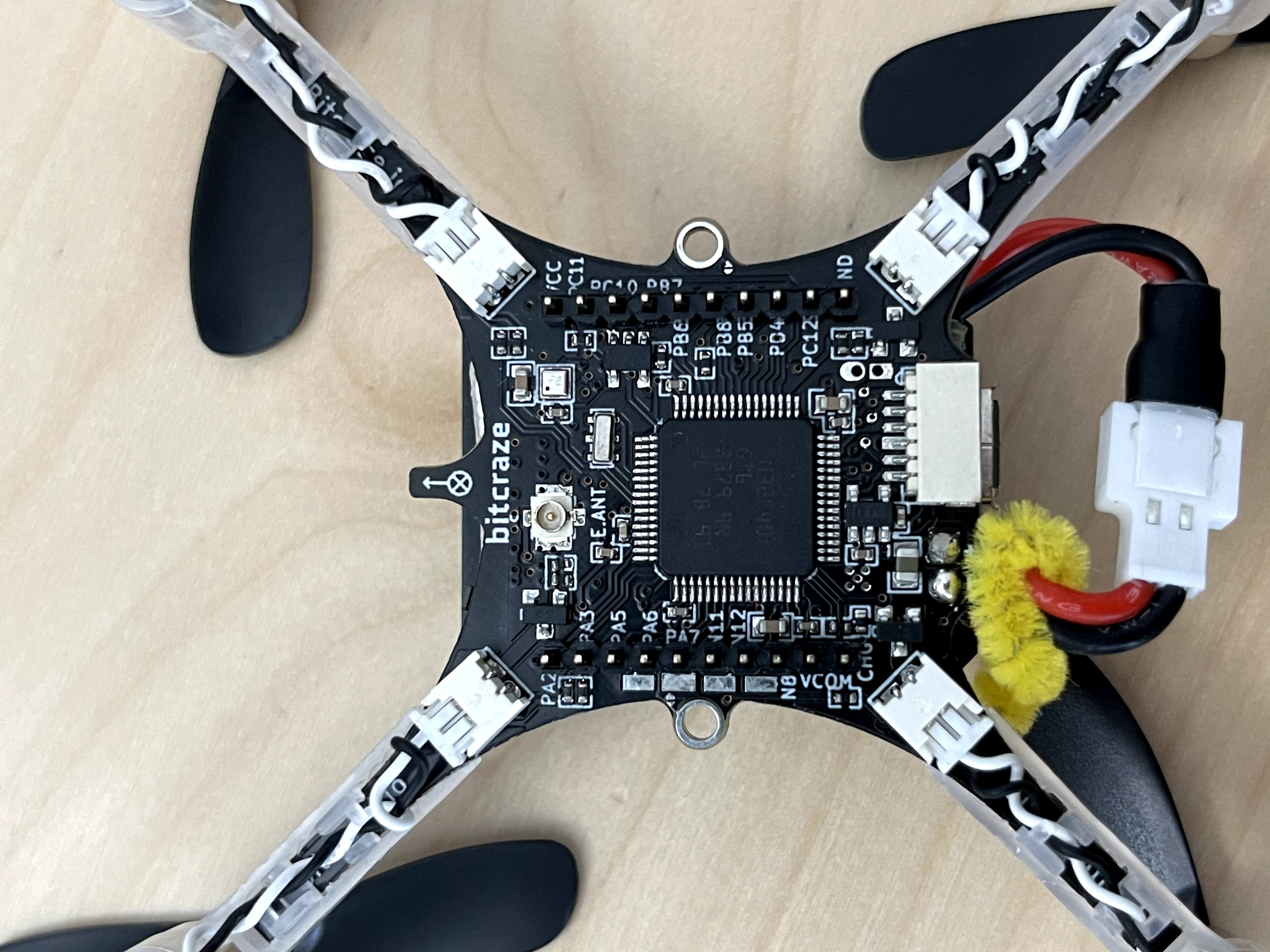

Re: Front Right LED and Motor Not Working
Hello Kimberly!
Thank you for the quick response. I'm attaching some photos of the crazyflie. The issue seems to be on the arm of M1. Nothing seems visually wrong, so I'm unsure what to do next.
I agree, most likely a HW failure. It could be anything in the chain
SW -> STM32F4 GPIO -> PCB trace -> resistor -> mosfet -> soldering -> connector -> motor
As you have tested with different motor my best guess is the soldering of the resistor or mosfet or the mosfet itself that is bad. From the pictures I can't see any bad soldering. You could try and check for yourself. It is these components: If nothing easy found please send us an email to support at bitcraze.io and we will help you out with a replacement.
