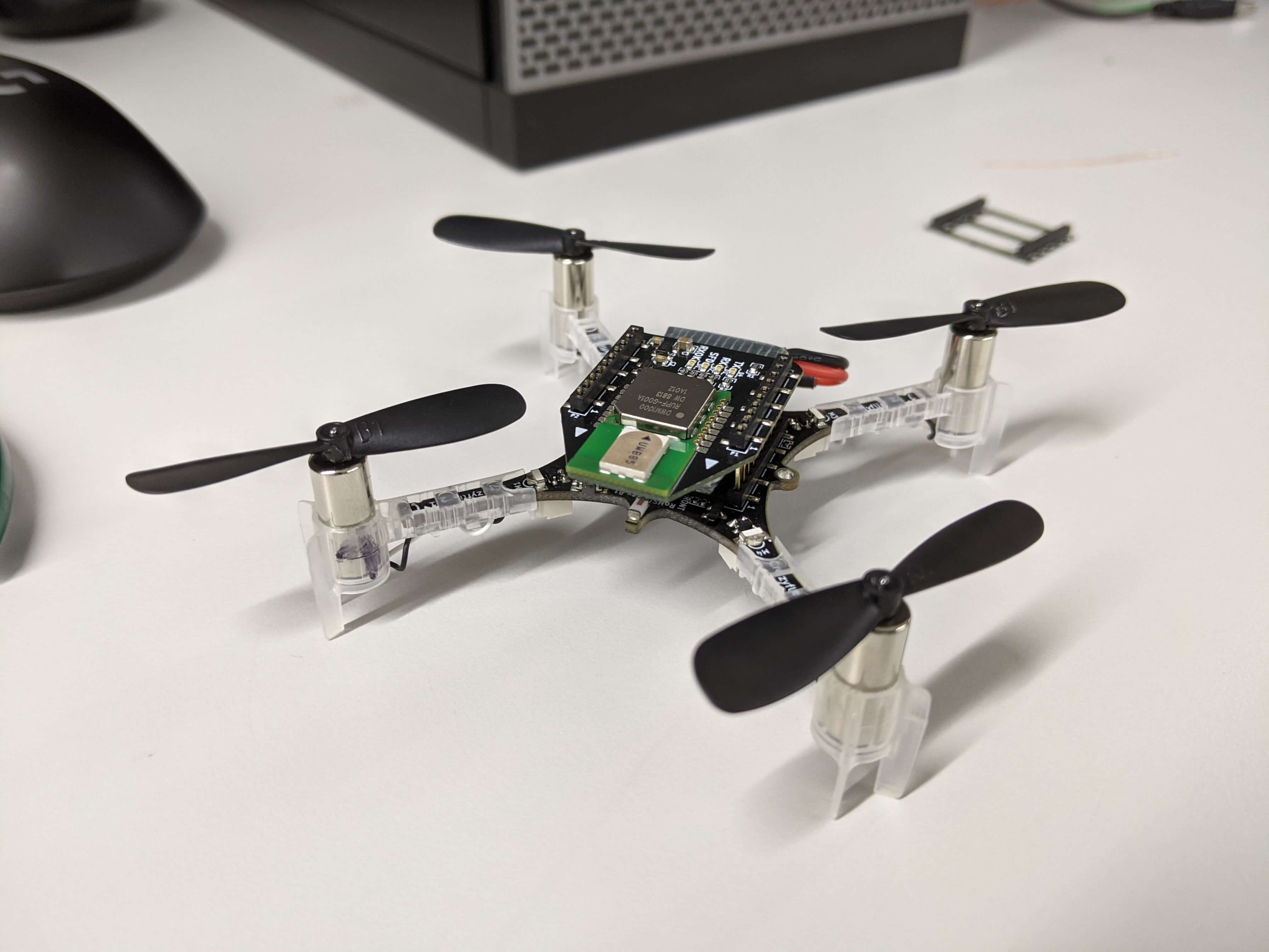

Here a photo of the crash victim:

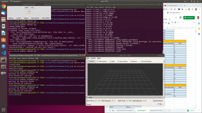

Screenshot of terminals:
![Image]()

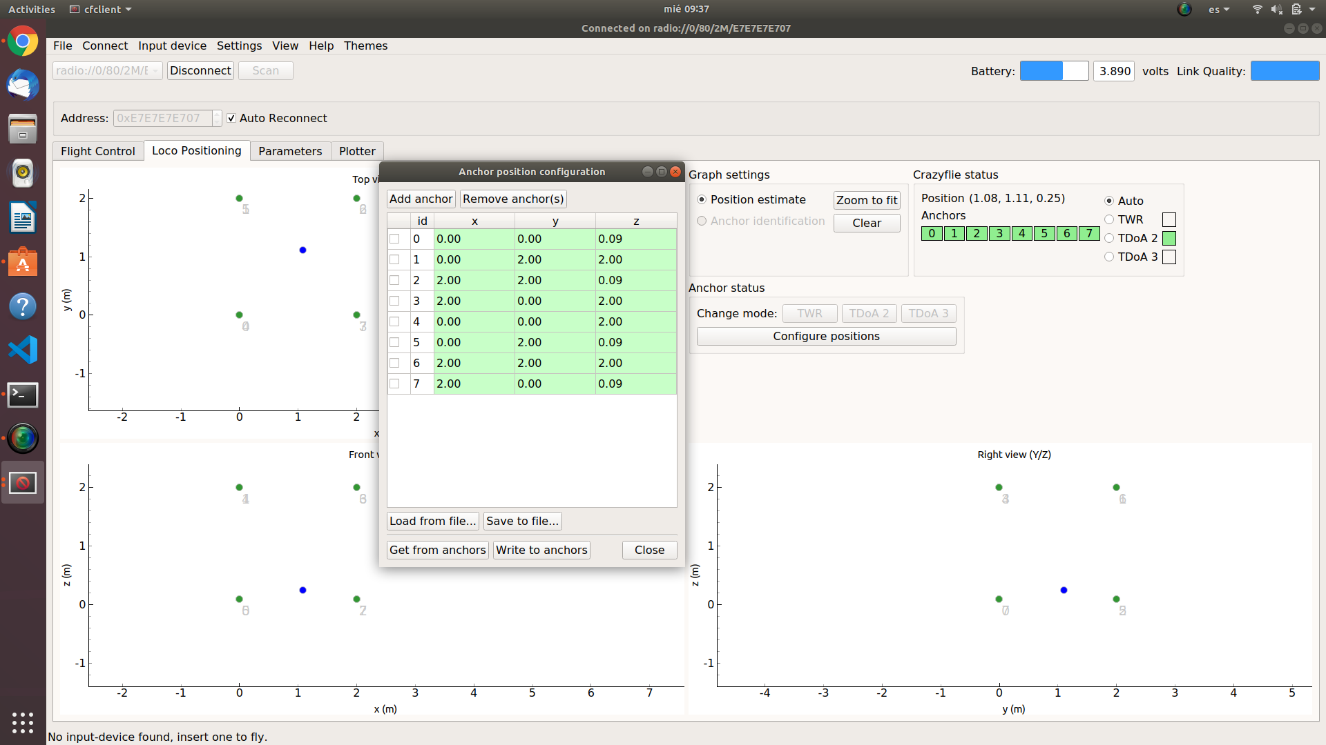

This is how I set the LPS, it is a cubic 2m x 2m x 2m with 1/2" PVC pipes structure, something I don't understand is that the CF in the screenshot below is on the floor, but the estimator shows that the Z distance is 0.26 meters, is there a way to fix that?

With TWR mode the CF doesn't fly away, it respect the ordered positions whether or not it has Flow deck with LPS, however, It has slightly Z measuring errors, I'll need to fly a 8 CFs swarm, Is it strictly necessary to use TDoA 2?

Yes, TDOA must be used. TWR will not work with multiple crazyflies
