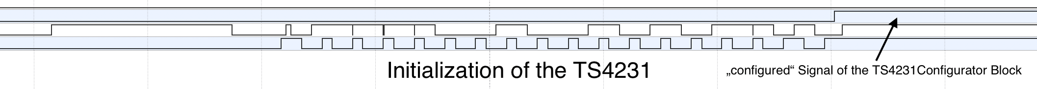

- Initialization of the TS4231fails even if the "configured" output of the TS4231Configurator.v block changes to '1' (screenshot of the initialization captured with a logic analyzer is attached)

For the chip initialization I would check the connection: the connection to the sensor is usually pretty sensitive and maybe there is noise on the line. You cannot trust the configured signal since I never implemented the readback of the configuration word.

Chip initialization:
You are right, the connection is definitely very fragile, but in my case it should not be a problem because the sensors (tested several) initialize without problems on my original system. I have also compared the timing and except for not reading back the configuration, it was quite similar.

after I had some time the last days to have a closer look at the code I have now also checked the sensor initializing problems. I probably found a bug in the "ts4231Configurator.v" where the 15th bit of a 15 bit wide vector is accessed.
I have created a Pull Request: https://github.com/bitcraze/lighthouse-fpga/pull/13
Unfortunately I haven't had the chance to test the new code on your board yet. On the HX8K board however, the sensors initialize now without any problems.
