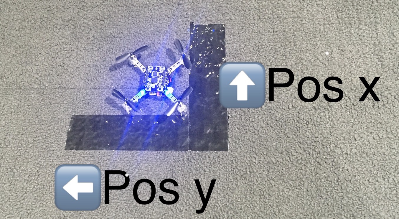

hey PB_ you are right, the X and Y axes are flipped in the geo data, only the Z axis is flipped in the the state estimator.
if the crazyflie reference frame is used, (https://www.bitcraze.io/documentation/r ... finitions/)

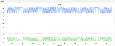

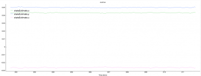

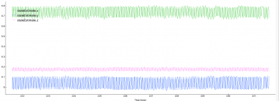

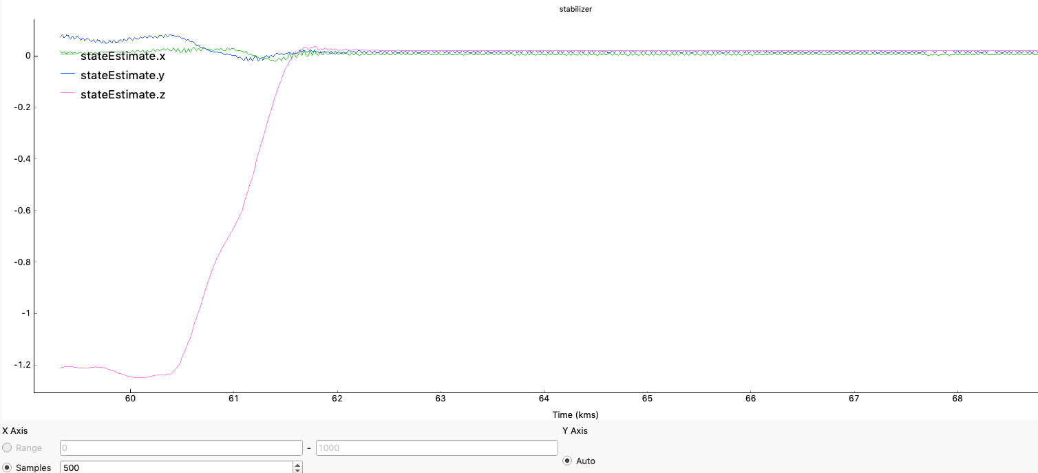

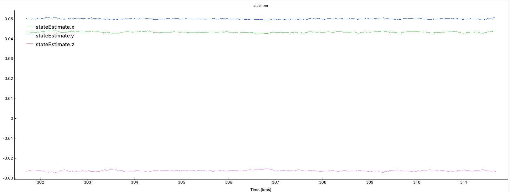

and the geo data is read (X,Y,Z) {.origin = {-2.258867, -1.303101, 2.312021, },

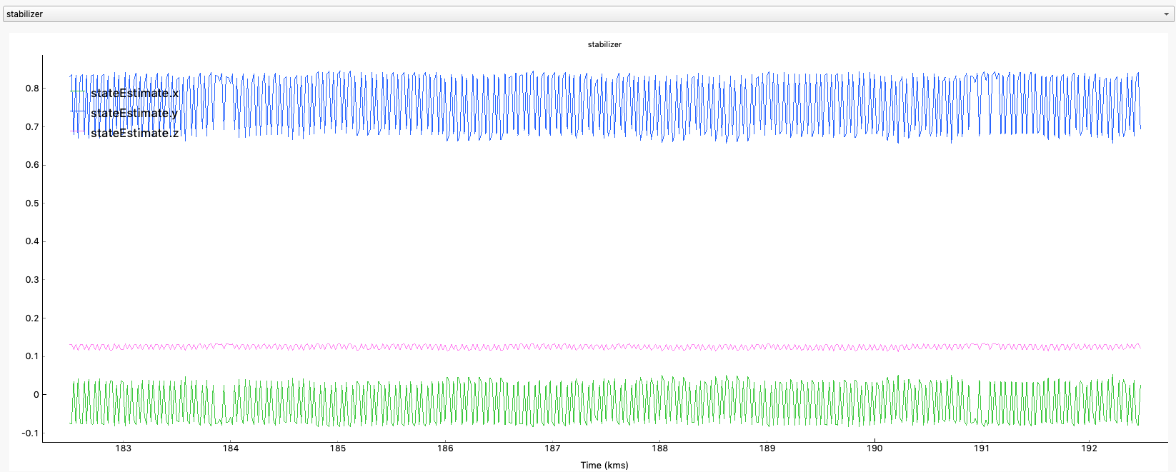

when in fact the baste station is +2.2m and +1.3m away on the x and y axes respectively. before i did anything, I placed the drone on the floor got the geo data, flashed the drone, ran the client and screenshot the state estimator. all looks reasonable when I start the client. placing the drone (.8, 0, 0) is ok butI get some funny variance of around .2m placing the drone (0, .8, 0) is ok as well but still get that variance lifting the drone in the air is a major problem, the state estimator thinkis it is -1.2m Cheers
joe
