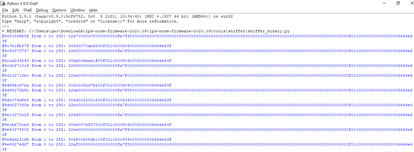

I'm the beginner of Python but can run sniffer_binary.py to dump the log over shell, seen attachment.
The next is to decoder it for better understanding TDOA2 protocol ….

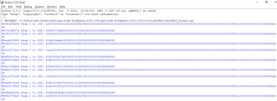

However, I don't know exactly and fail to use TDOA2_Decoder.py to decode these packages. The shell hangs and is likely waiting for input... see attachment.

The general idea is to pipe the output from the sniffer into the decoder
Assuming you are using a unix shell you should do something like this
./tools/sniffer/sniffer_binary.py | ./tools/sniffer/tdoa2_decoder.py

I'm not using unix shell. how do I get this script running with python?

I'm not a windows expert, but I think you can pipe in windows as well.
I don't have a windows machine to test on, but try something like this:
from your normal command prompt (not in python), cd to the root of the repository
Then run the scripts
python tools\sniffer\sniffer_binary.py | python tools\sniffer\tdoa2_decoder.py

Thanks! It works now!
