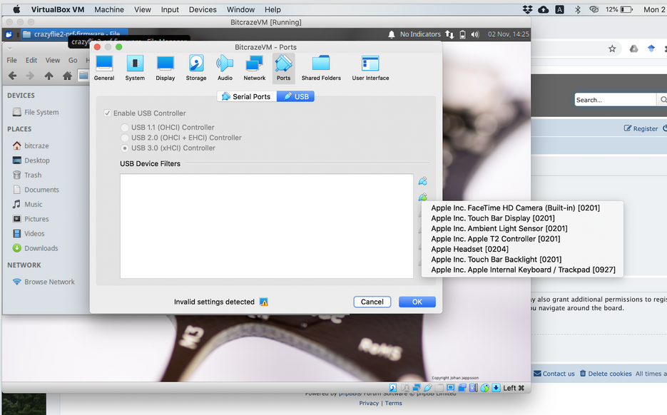

But now as it showed in the attached image the VM cannot recognise the existence of crazyflie, even if I use it on the native setting and try lsusb ?

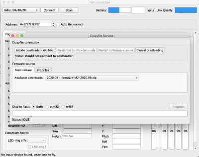

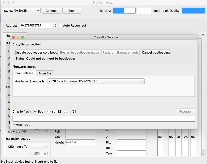

Crazyflie Radio can find the quadcopter and connect to it. Even if I used my mobile I can connect to the quadcopter. However, Nothing more happened only M2 LED is on and blue.
Even the cold boot has failed as it shown in the attached image.
