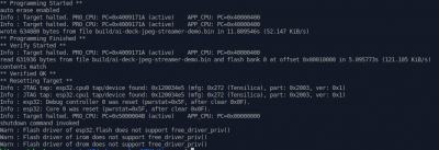

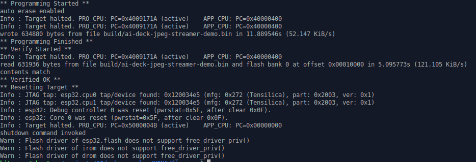

추가적으로 docker를 이용하여 밑에 명렁어를 실행하였습니다.
docker run --rm -it -v $PWD:/module/ --device /dev/ttyUSB0 --privileged -P espidf:3.3.1 /bin/bash -c "make menuconfig; make clean; make all; /openocd-esp32/bin/openocd -f interface/ftdi/olimex-arm-usb-tiny-h.cfg -f board/esp-wroom-32.cfg -c 'program_esp32 build/partitions_singleapp.bin 0x8000 verify' -c 'program_esp32 build/bootloader/bootloader.bin 0x1000 verify' -c 'program_esp32 build/ai-deck-jpeg-streamer-demo.bin 0x10000 verify reset exit'"
그림과 같이 되었는데 문제가 무엇입니까?

- Posts: 1050
Re: Wifi video streamer
The flash location of the AIdeck for the Nina can be found here:
https://github.com/bitcraze/AIdeck_exam ... ramming.md
Also check on which USB port your programmer is with dmesg (on ubuntu). You might need to change that line in the docker command.
