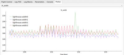

To check manually if the deck is still working fine, you can also log the variables lighthouse.width[0-3], this is the raw pulse width received from the lighthouse deck. If all works well, the width should be non-0 and changing for all sensors (0 to 3). For lighthouse 2 the width should be fairly constant and be related to the distance between the deck and the base-stations. I attach a picture of what that looks like on my side:

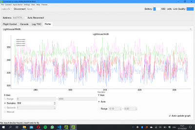

We could make some progress with the new decks, but we still couldn't fly a crazyflie stably with the lighthouse system. We often have problems with two basestations. Probably because they are too far away. So our current setup is only one basestation approximatly 2 meters apart the drone, 1.5m off the ground and directed to the deck, but we dont get very promissing data.
The graph with the lighthouse.width values is not nearly that constant as yours.

These data do not necessarily look bad to me: with LH2 the pulse width mainly depend of the distance to the lighthouse, the laser modulation is used to identify and decode the pulse timing. This data is mainly useful to see if the deck is working, in your case it confirms that your deck is working and is receiving data from two LH2 basestations.

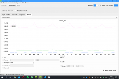

In this one the crazyflie is just standing still on the ground without being moved:

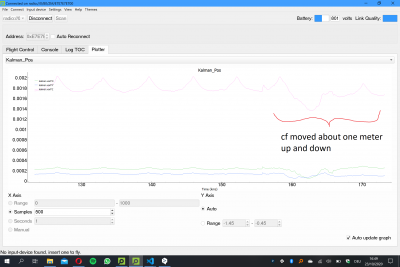

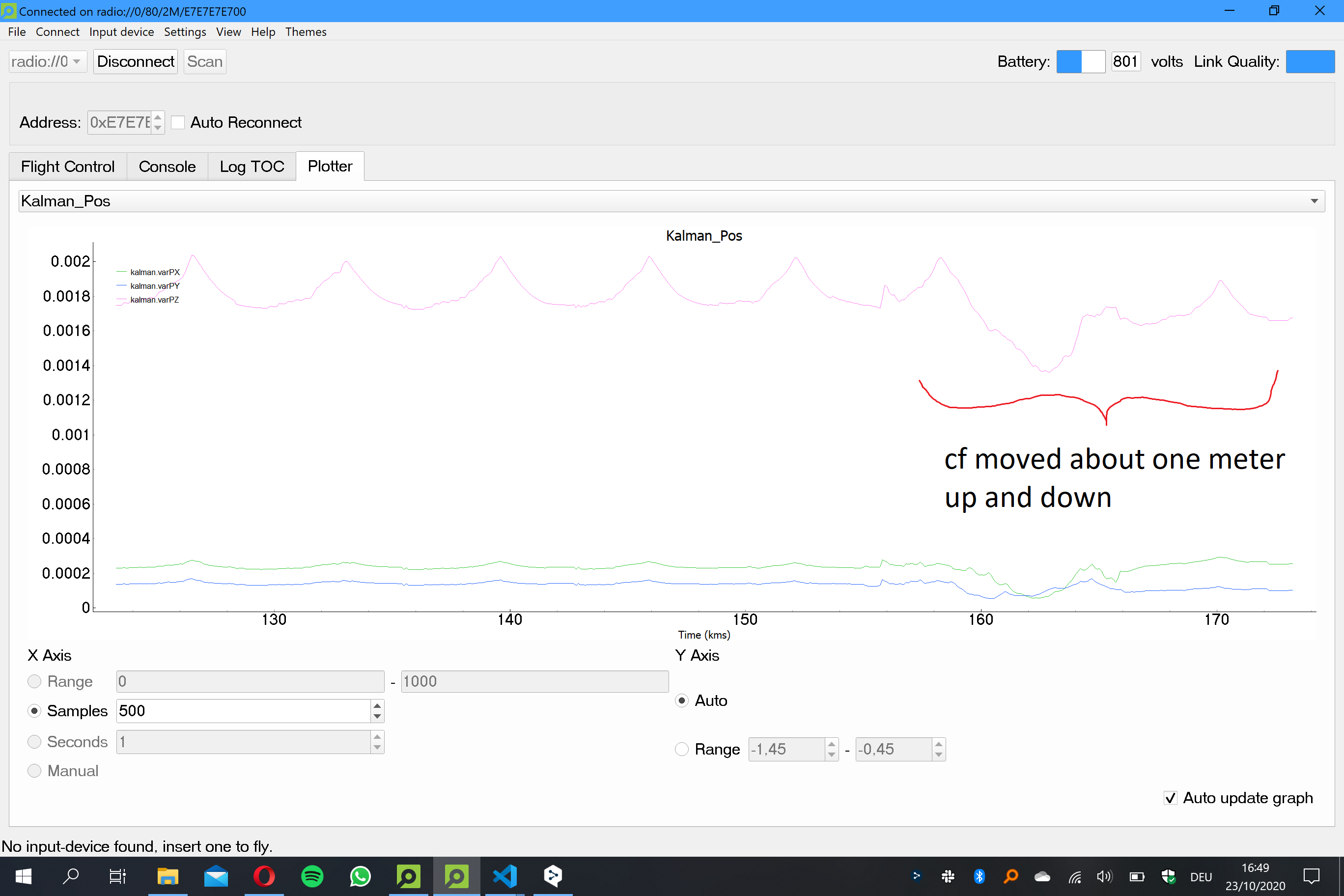

Here I moved the cf up and down to compare the results:
Sometimes the kalman values just kept changing after I moved the cf until I moved it again, but maybe this was just because the drone was tilted to much.

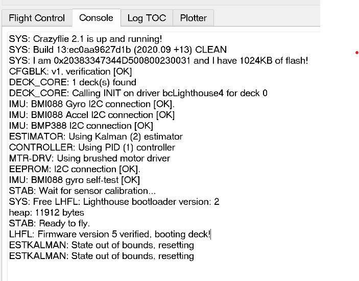

Another small problem was that that the drone restarted because of an error:
SYS: Assert failed at .//src/modules/src/kalman_core.c:253
It seems that it only happens when it was started without a bs near its location. It wasn't a problem for me, but I just wanted to mention it because it is probably interesting for you to know.

Thanks for notifying about the assert by the way. We created an issue for that on github: https://github.com/bitcraze/crazyflie-f ... issues/635
