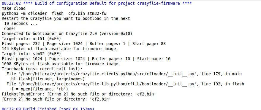

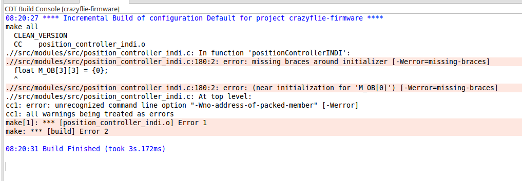

Whenever I attempt to build the file I get the errors shown in attachment 1. I then attempt to flash the drone with the radio and I get an error shown in attachment 2. I get this error with any of the 8.XX version VMs. I am using the most up to date virtual box. I'm also updating all projects when I first log in. What am I doing wrong? Any help would be appreciated.
Attachment 1
Attachment 1
Attachment 2
Attachment 2

I was not able to reproduce this problem. Did you run the "Update all projects" script from the VM desktop?
