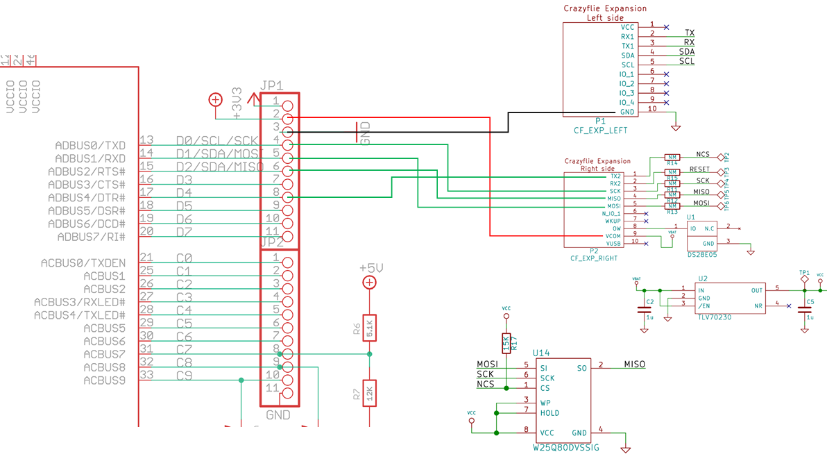

zooeyday
Posts: 6
Joined: Mon Aug 17, 2020 2:35 pm
Re: Request a more detailed explanation on how to flash the lighthouse bootloader
Post by zooeyday »
HI. arnaud
After doing something else for a while, I now have a chance to test.
I tried to flash by making an interface board by referring to the circuit you attached.

I have checked the circuit and pin map several times and there seems to be no problem with it.
Looking at the flash ID, reading and writing flash seems to be normal.
Arnaud, if you help me one more time, I'll be happy.
Thanks in advance.
