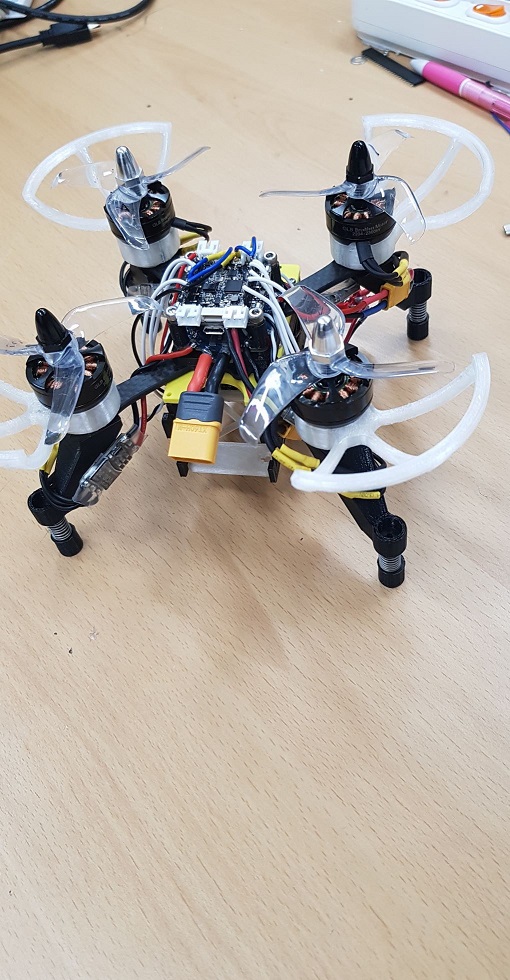

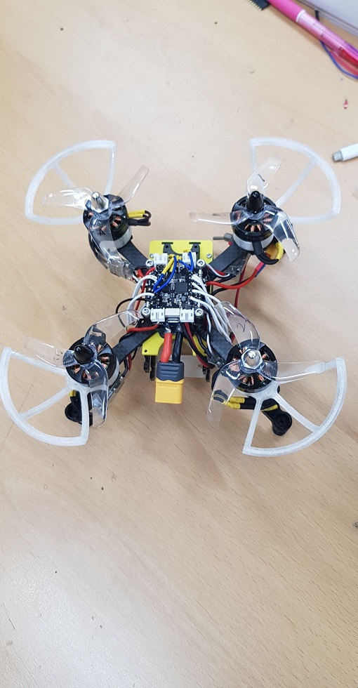

We are making a new drone using Bolt.
We use the code of the existing crazyflie firmware for most sensor inputs, but we try to use the code we want for filter codes and coefficients.
We want to replace our code with the existing code, but we don't know exactly where to fix it.
Creating a new task has already been successful, but I don't know which part to correct to replace the existing code.
I wonder exactly what code the sensor's data value is entered into the queue.
Q : Based on FLOW Deck, I would like to add a code to use a filter other than just a Kalman filter.
If I want to use the existing ROTS priority but use the filter differently, which part should I correct?
If you know what you need to add and what you need to remove to insert the new code, please answer.
Even if it's not accurate, it'll be very helpful
Now I think I should refer to and modify the static pool 'appendMeasure()' function of <estimator_kalman.c>
If I'm right, can you teach me a simple example code?
