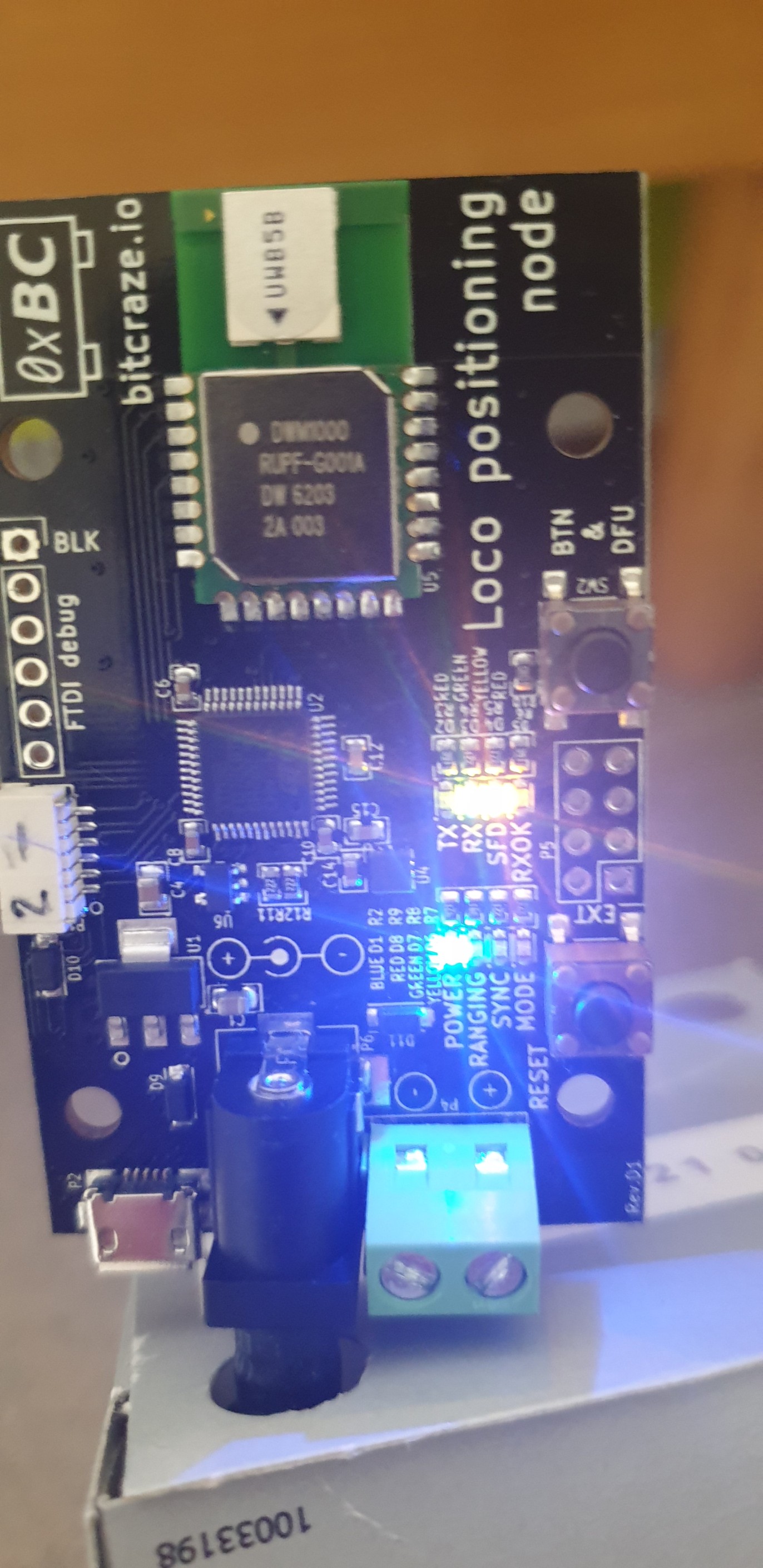

I just switched to tdoa mode with 8 anchors, I configured them with their Id from 0 to 7, but I have a problem with a single anchor. its LEDs do not flash like the others also it's not displayed on the cfclient, I configured it several times but always the same problem.

Are none of the LEDs flashing or are only a few? Which ones are flashing specifically?
If all the LEDs are not on at all, then you might have to check your power supply. If the LEDs are on, then you might just need to reconfigure your LPS node with an micro USB cable to already have the right method that you usually use.

Thank you for your reply, I reconfigured the anchor several times I tried with several cables and all the ports on my computer. but I still have the same problem.
Here is a photo of the anchor after connecting the crazyflie with the other anchors:

Hmmm... it seems like it is configured correct, since it is in the same range.
By the way, i saw on your picture that number 2 was written on there, but this node is configured as number 0x07 (so 7). Is that correct?
Also the tag mode anchor list is missing node 0x00, so it might be that you are looking at the wrong node that is malfunctioning.
Reflashing the mallfucntion node accoridng to the tutorial will also be something you can try then (https://www.bitcraze.io/documentation/t ... -the-nodes)

No I was not wrong on the anchors because I configured it with an id 7, I did all the steps indicated here: https://www.bitcraze.io/documentation/t ... -the-nodes
For the ids I took from 0 to 7, I have all the anchors working well except the 7 the problem that it works at the beginning but after 10 seconds it disconnects from cfclient.

I am just reciting what I see on the on configuration output, since 0x00 is missing on that list. But okay, let see if this can be fixed.
- Try to reflash the node would be the first to start
- It might be that the power input is not sufficient. You should check by measuring if it is indeed between 5-12 V and 150 mAh at least. Be ware that if you have a very long cable, the output at the end might be less than you expect
