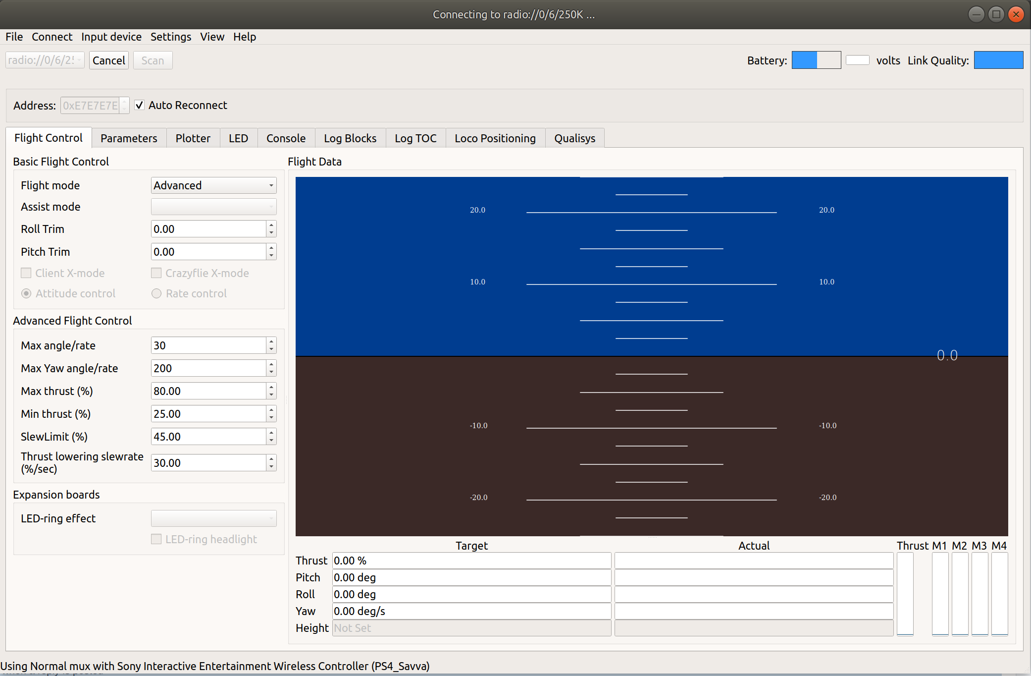

After that I restarted the drone; when scanning for devices, the drone pops up. When I hit connect, the GUI says that it's connecting to the radio, but it never actually connects (it just states that it's "connecting to radio"). Interestingly, at this point I can control the drone with the joystick; but I don't get any Flight Data back.
Screenshot of gui:

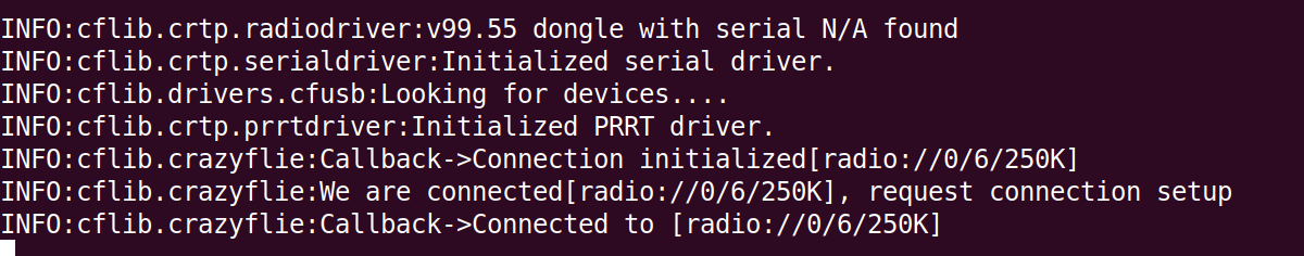

Screenshot of terminal while it connects indefinitely:

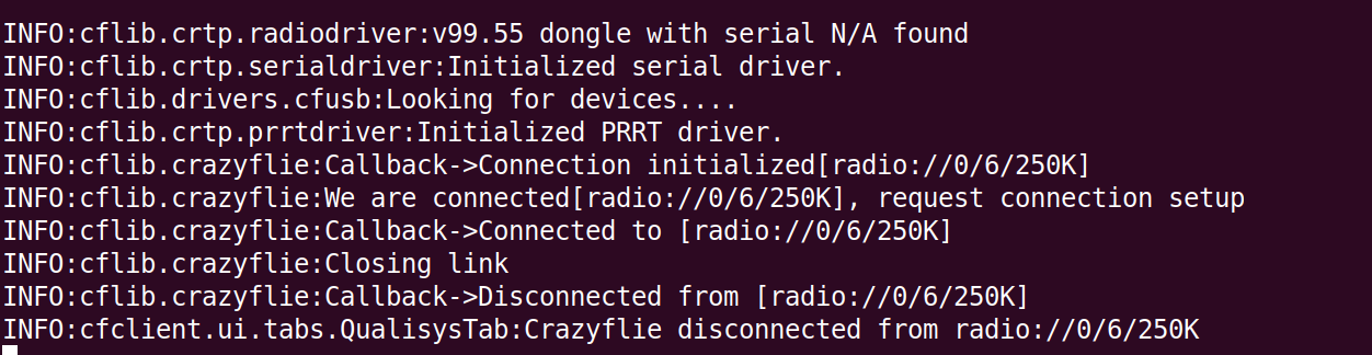

Screenshot of terminal after I hit cancel in indefinite connection:

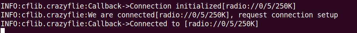

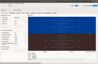

i am having the same issue as before: a crazyflie would be found during a scan, connect to the crazyflie, the terminal says that it's connected to the the drone, but then no info is received. Here is a screenshot with a crazyflie with 2017.6: here is a screenshot from a crazyflie with software unkown to me, but the one that works (like I said, I inherited the creazyflies): Is there a way to check what firmware is on the second crazyflie? Although I bet that it's custom...
