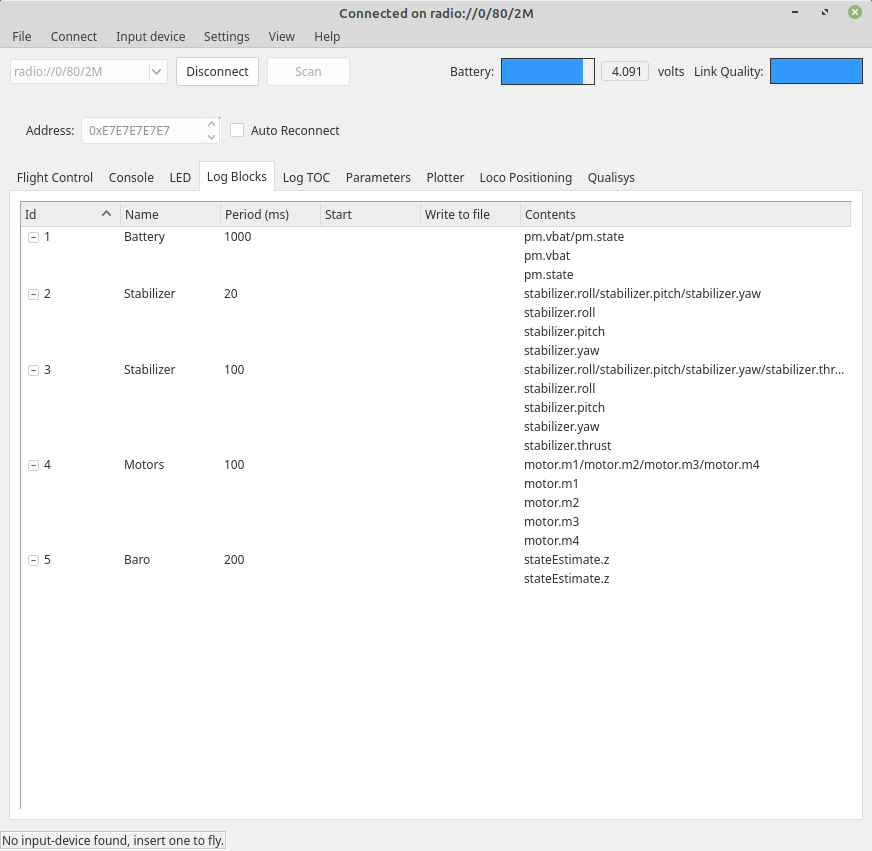

I'm having difficulties with the "Log Blocks" tab in cfclient: according to the screenshots in the manual/tutorial the variables to be logged can be selected using the respective checkboxes but these are not visible in my client. I'm running the client on a Linux machine (Linux Mint 19.3, Linux 5.3.0-40-generic #32~18.04.1-Ubuntu SMP Mon Feb 3 14:05:59 UTC 2020 x86_64 x86_64 x86_64 GNU/Linux). Otherwise the cfclient runs fine.
I've noticed that I'm getting multiple debug/error messages in the console output when doing a mouseover in the area where the checkboxes should be:
===== 2020.03.02 21:03:46 =====
File "/home/uwe/Development/bitcraze/crazyflie-clients-python/src/cfclient/ui/tabs/LogBlockTab.py", line 290, in paint
subElementRect(QStyle.SE_CheckBoxIndicator, option)
TypeError: subElementRect(self, QStyle.SubElement, QStyleOption, QWidget): not enough arguments
More details can be found in the attached console dump file.
Any ideas what's causing this?

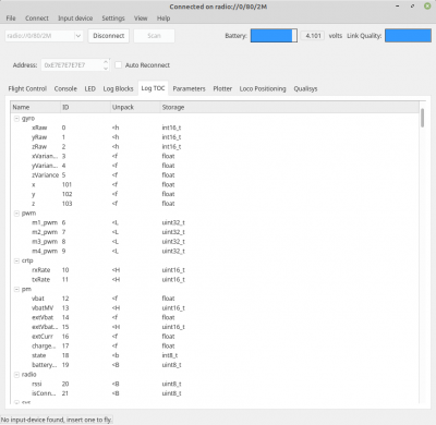

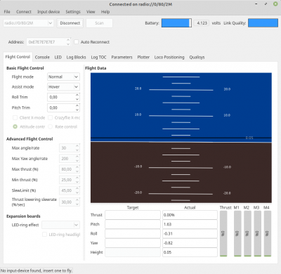

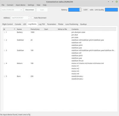

Re: no logging checkboxes visible in cfclient

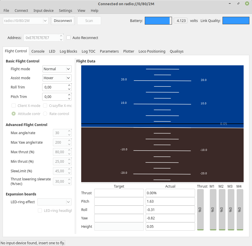

here are the requested screenshots of my cfclient. The only tab showing a problem is the "Log Blocks" tab, afaik.
Let me know if you need more info about my system / installation. Thanks for your assistance.
Regards
Tintin

- Posts: 630
There used to be a similar problem on OSX, see https://github.com/bitcraze/crazyflie-c ... issues/308
QT is usually the problem, it might be worth trying another version.

- Posts: 630
We have one linux machine that uses 5.12.3 that seems to work.
I have 5.14.1 on my machine (OSX) and it actually seems to be a problem there. The check boxes appear too far to the right.
I'll create an issue for it https://github.com/bitcraze/crazyflie-c ... issues/393

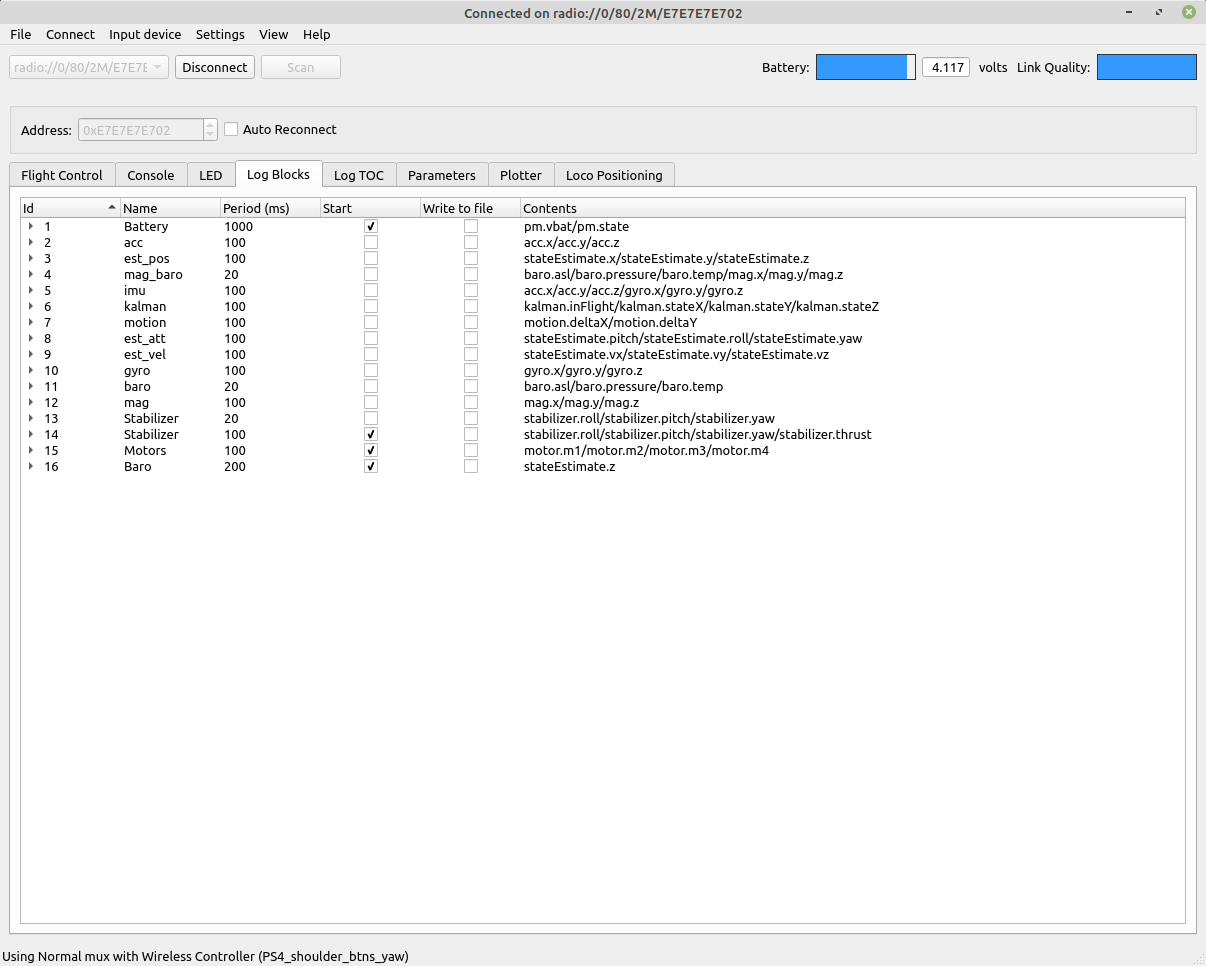

Here's some updated info on the issue: after upgrading from Linux Mint 19.3 to LM 20 the logging tab is now displayed correctly:
