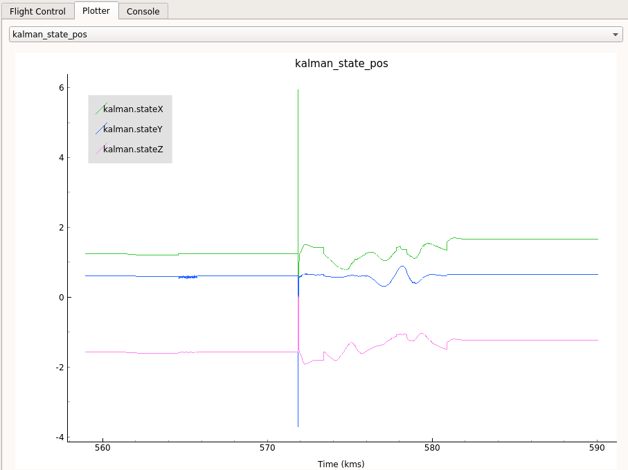

My console window shows the following:
This is what I get when I log kalman.stateX/Y/Z.
I moved the cf around with my hands (not w/ a joystick or motors turned on).
The altitude position is showing negative values. I don't get why is that. Where's the origin located? Is it one of the base stations?
Re: Lighthouse Position always at zero for CF
The origin of the lighthouse coordinate system depends on how you calibrated it. If you used a tracker to calibrate the system I think the origin ends up at one of the two base stations and then your graph makes sense.

Here's the new kalman state positions.
I think the topic can be closed.
