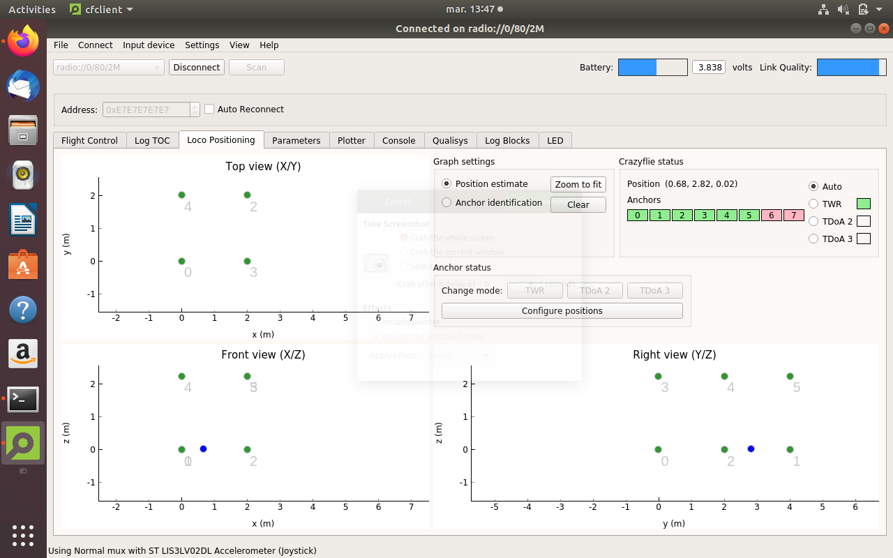

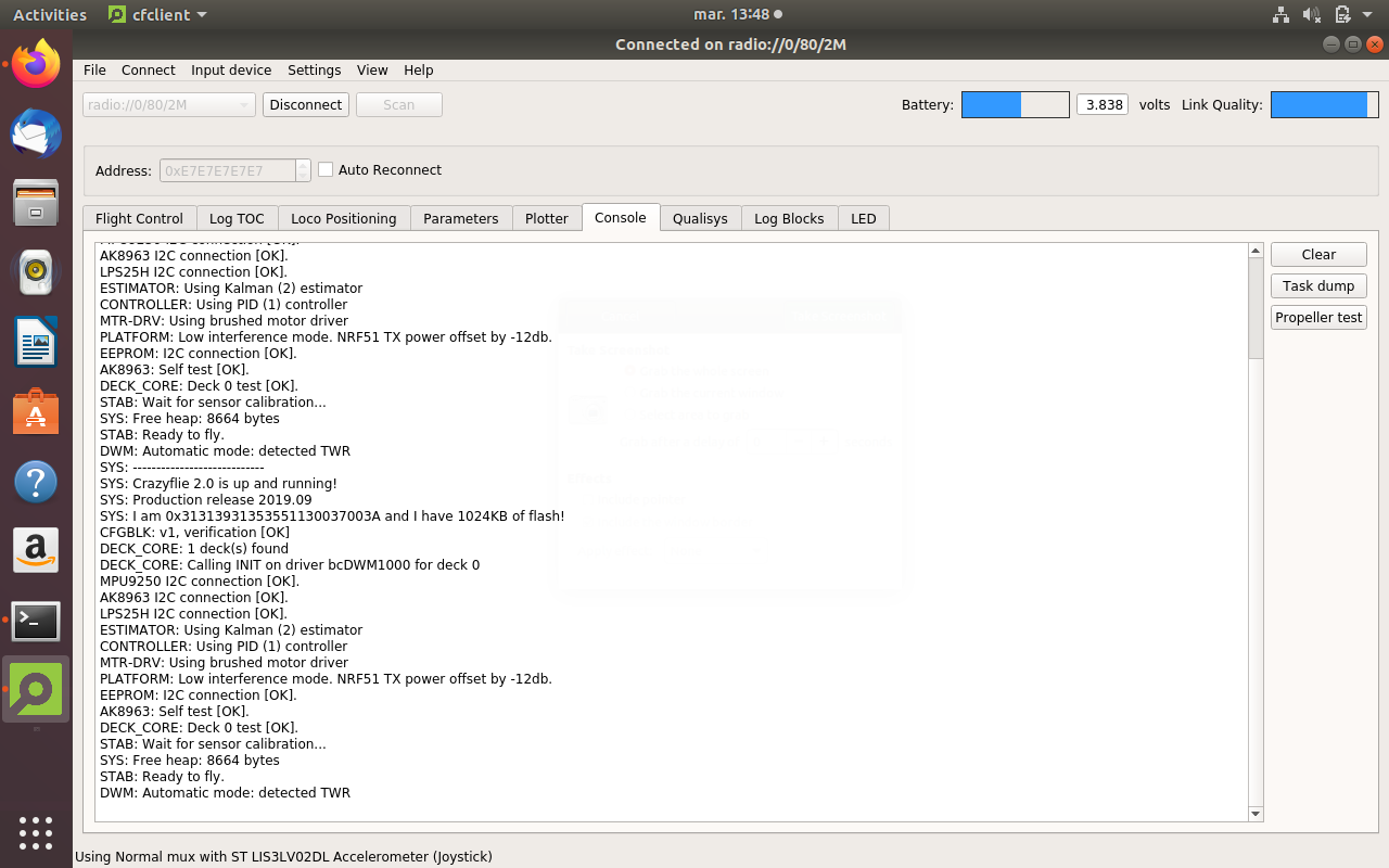

Can you please attach a screen shot of the LPS tab in the client?
Re: stability of the LPS system
thank you for your reply
here they are the screenshot of th LPS tab and the console in the cfclient

It looks like the anchors are OK (assuming you are using 6 anchors) and they all are in TWR mode.
The next thing to check is that the anchors actually are at the physical positions that they are configured for, to make sure you have not accidentally mixed up two anchors.
Finally check that you place the Crazyflie on the floor, pointing in the direction of the X-axis when turning it on. This is very important since the LPS system can not measure the orientation and simply assumes it is pointing in positive X direction when started.
