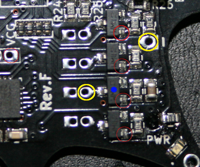

I had to solder the M3 wires back together which left them open and they accidently touched while I was flying. Now the motor spins at full speed when the battery is plugged in and none of the others are responsive. I guess I shorted it. Anybody have an idea what happened and if there is a way to fix it?

Yes, you can most likely fix it. Do you have a multimeter? My guess is that the M3 mosfet transistor shorted and needs to be replaced. This can be verified by measuring the resistance between the two yellow circles in the picture. If there is a short (~0 ohm) you need to replace the PMV31XN transistor marked with blue in the picture.

I tested the resistance last night and it is reading differently than the others. All the others had a resistance of about 5.5 on the lowest setting of the multimeter, and M3 was reading 0.7. I'll do my best to replace the transistor. I'm guessing the best way to do that is by using a solder sucker to remove the transistor?

Thanks for your help. Replacing that transistor worked great. I made sure and put some heat shrink around those open wires this time. That was not easy. I used 15W on the soldering iron at first, but it wasn't melting the existing solder so I bumped it up to 30W and it worked. Those transistors are very tiny. You must have a better magnifier that I do. I could barely see if I was getting a good solder. Now to work on the training wheels. I think I read some where that the training wheels hack uses steel wire?
