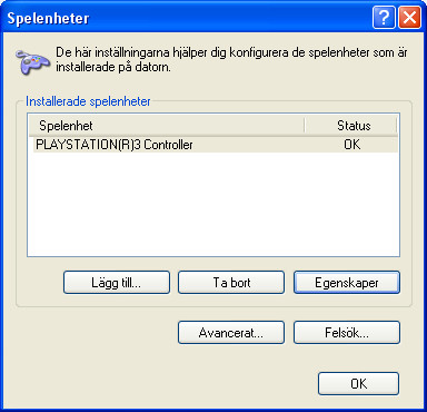

Re: Cannot get PS3 controller to work
Have you tried pushing the middle PS button when running the cfclient? I also have a PC with WinXP and it displays it like the picture.
- Attachments
- WinXP PS3 controller.JPG (36.43 KiB) Viewed 19046 times
Tobias:
I get a screen like the one you show only when I access the Device Manager, but I have to go through the Start button to get to it. I assume that "Spelenheter" is the Device Manager. Am I correct?
Sorry for my Swedish WinXP. It might be called something similar to "game controllers" under the device manager. I installed it such a long time ago and can't really remember how but I'm almost certain it is this one: http://www.youtube.com/watch?v=fotFIDi7BHU

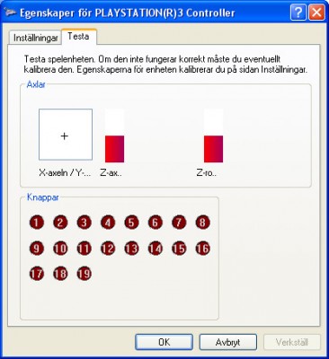

If you enter the properties for the PS3 controller in the picture I sent above do you get this screen and can you see the input from the controller? The predefined PS3 configurations works well for me so you should not have to create new ones. I sometimes have to push the "PS" button for the values to appear in the flight data->target values.
