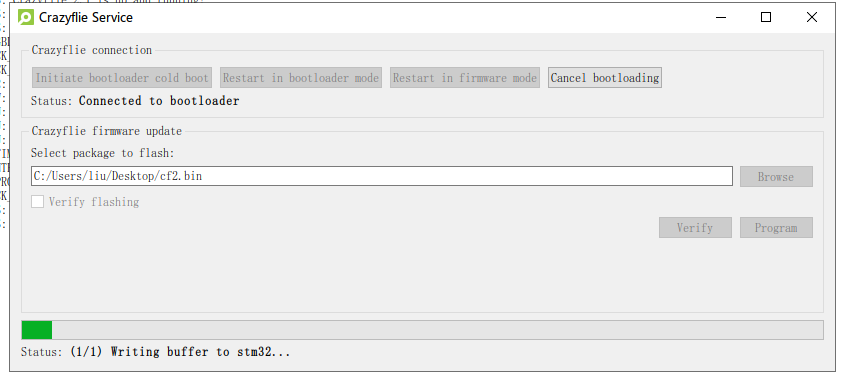

Re: How to generate the zip file for upgrade?
by the way, I'd like to mention that it is possible to flash cf.bin directly via cfclient , instead of generating total zip flie.
- Posts: 1050
Yes that is also possible. This only works for the STM32 though. For the NRF51 you still would need to use the zipfolder.
