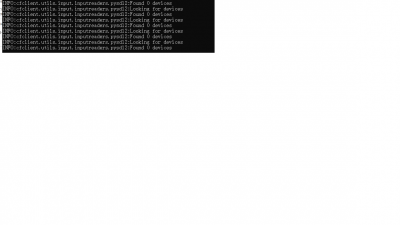

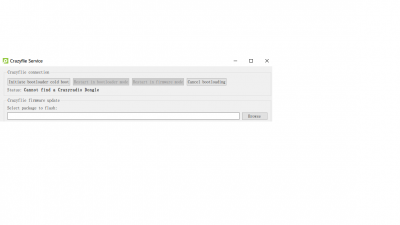

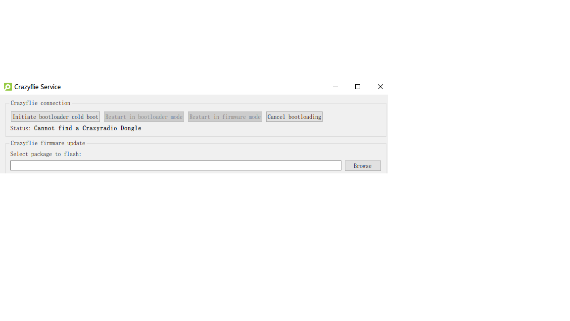

I am a new guy into crazyflie 2.1 ,and I am confused about how to flash a firmware into the drone.
all I have tried is opening pc client ,and setting the drone into bootloader mode, connecting the drone and pc with usb cable,letitng the pc client into bootloader mode according your official instrcution . But the client side seems not recognise the drone , and a CLI windows just reapeatly prints "found 0 device" .
do I must buy a Crazyradio PA to continue my flashing procedure ? or is there any other way to flash the firmware just using a usb cable?
thank you so much~~~~~~

It is possible to do it through dfu: https://wiki.bitcraze.io/projects:crazy ... fu?s[]=dfu. But I must warn you, if you do this the wrong way you will break the bootloader and you would need an crazyradio or a debugger anyway... So I wouldn't risk it if you are a novice. You can also flash new firmware from the iphone/android app for the crazyflie but that is a bit slow and tedious if you want to do development.
I would just get a Crazyflie PA if I were you.
