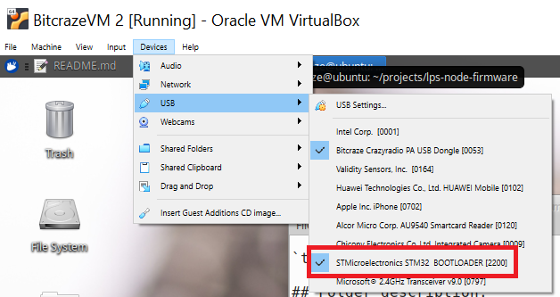

Ah... USB problems with VM's are really difficult to solve. So you are not seeing the 'STMicroelectronisc STM32 BOOTLOADER' like in this image?
Are you running the VM in Ubuntu, IOS or Windows?

Just a small update, you have to make sure 'STMicroelectronisc STM32 BOOTLOADER' is selected: like this:
After selecting I got the following in my console:

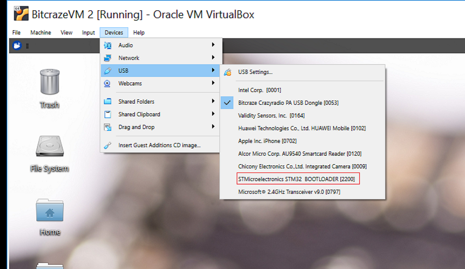

I think this may be the root of the issue since I got an error when I tried to perform what you showed. :?:
I got the following error in my VM screen.........
Could anyone please suggest me a method to overcome this issue?

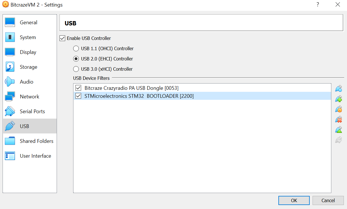

- Check if the following setting is enabled in the Oracle Virtual box before you open de VM
- If it all does not work, restart your host computer and VM.
Eventually the USB devices will connect after trying these things, but I couldn't find a magic formula that worked immediately. These USB problems with virtual box is different on every other host computer... (I have windows 10 btw)
