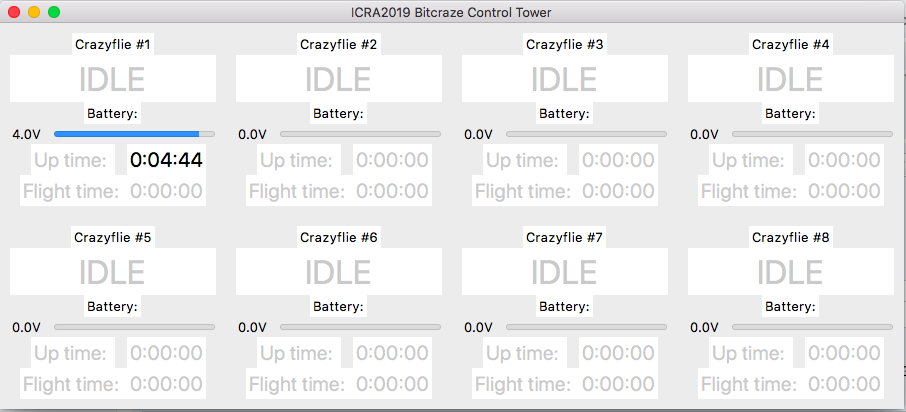

4. Run: control tower (https://github.com/bitcraze/crazyflie-f ... l_tower.py
control tower gui running fine.

Posts: 2538
Re: Control Tower Error
Post by arnaud »
You can comment-out drones from the list in the control tower if you want to fly less drones.
The control tower will automatically order a drone to take off if it is both ready and its battery voltage is above a certain threshold (by default it is 4.0V).
Your screenshot of the GUI shows one Crazyflie connected in IDLE state. It should be in ready state in order to take-off.
There is a couple of things you can try:
1. Make sure you are flashing the experimental icra2019 branch
2. Make sure the base-station geometry is correctly set in the Lighthouse deck driver using the client, as described in the lighthouse getting started: https://wiki.bitcraze.io/doc:lighthouse:setup
3. Once the Crazyflies have their position, the front right LED should be lit in green.
4. Only un-comment URIs you are using in the control tower
5. Modify the take-off voltage threshold to a value under the current voltage of your Crazyflies.
