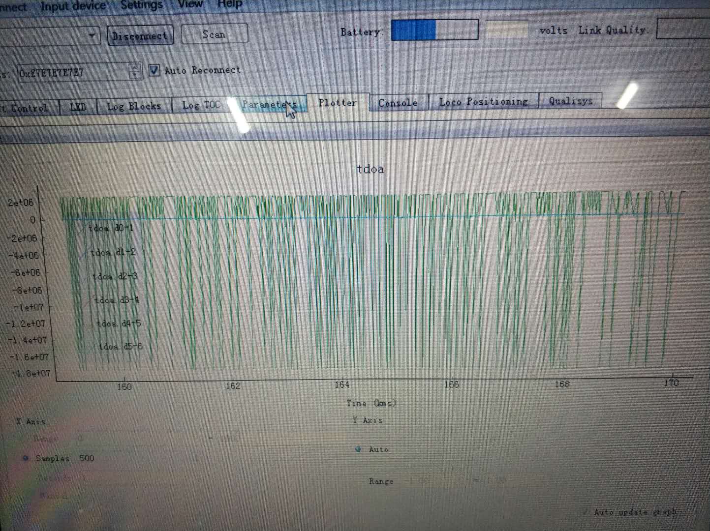

hi,
with 1 crazyflie2.0 and 6 anchors, I try to get the distance diff form cfclient Plotter Table, but don't get right data.
tdoa2 mode don't get the distance diff from cfclient Plotter Table

Re: tdoa2 mode don't get the distance diff from cfclient Plotter Table
I am not sure these log variable are still relevant with TDoA3 since TDoA3 ranges with random couple of anchors.
What version of the firmware are you using and what TDoA mode are you using?
edit: Sorry, I missed the TDoA2 in the title. The question about the version of the firmware is still relevant though
