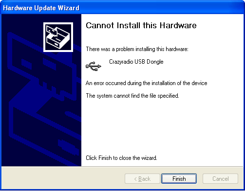

I'm trying to install the crazyradio driver for Win XP. I point the install wizard to the driver found at https://bitbucket.org/bitcraze/crazyrad ... driver.zip, but I get an error stating that the file cannot be found. See the following screenshot:
Crazyradio driver error
Any ideas on how to resolve this?

Hmm, you shouldn't have to update the Crazyradio to get it working in XP and I'm not sure the updating is working on XP. I'm running XP on one of my computers without any problem. I can't try to replicate your problem right now but might tonight. You can try the libusb driver directly if you want: http://sourceforge.net/projects/libusb-win32/

It seems that I got the driver to load after running Windows update and rebooting. I don't know what would have caused it to be able to recognize the driver files.
