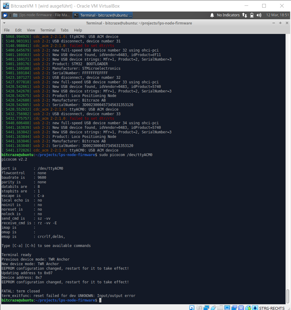

Hello everybody,
I would like to update my anchors. For this I have followed the instructions of Arnould.
See link: https://www.youtube.com/watch?v=ZgH4bLZdq2A&t=174s
Unfortunately it does not work, my anchors are still not operational.
The last step, when resetting comes an error message -> FATAL: term closed. See picture below.
Do you have any idea how I can solve the problem to finally start flying?

This is normal: the USB serial port is implemented by the LPS node MCU, if you reset the MCU you disconnect the serial port.
You seem to be able to setup the nodes in TWR mode, what problem are you having after that?
There is a getting started guide that is more recent that this video, you should most likely follow it instead: https://www.bitcraze.io/getting-started ... ng-system/
