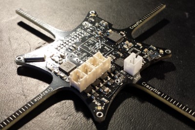

There is a possibility to use connectors which we have tried, not perfect but works. The PicoBlade connectors fit on the top side if they are oriented in a specific way. I'll try to remeber posting a picture of it tonight when I get home.
The motor holes have a 1.27mm pitch and are 0.6mm in diameter.
Re: Connect motors with pin headers?
Here's a sample picture. The M1 and M2 connectors need to be facing upwards and the M3 and M4 downwards for them to fit. The tricky part will actually be the mating connector on the motors as it is hard to attach them without proper tools. Also they will not fit through the motor mount if the connectors on the motor wires are added first. In the end I think it is easier just to solder/resolder, but the connector option is possible. A 1.27mm 2 pin header pin is another alternative.
