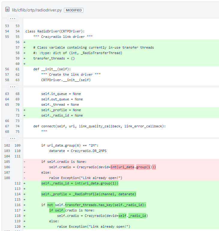

I've tried to use multi Crazyflie(more than one) with a single radio dongle.
So i searched forums to get how to do, and i found a similar question on Forums. Here's the link.
viewtopic.php?t=624
What i want to know is what version of python code is adequate to be edited.
I mean, I'm using now the latest version of Crazyflies and firmware, but that Post of the forum doesn't seem to in the same environment.
Is it okay just add some code (as marked '+' pictured below) into my 'radiodriver.py'(It's up-to-date)?
I really want to make my project to be succeeded.

That post is very old and thinks have evolved since then.
The lib is not capable to connect multiple Crazyflie out of the box, using one or multiple radios. There is a couple of example showing how to connect multiple Crazyflie with a single Crazyradio in the Crazyflie lib python repos. The most basic is multiramp: https://github.com/bitcraze/crazyflie-l ... ltiramp.py. Depending of what you want to achieve there is also higher level lib like the swarm class: https://github.com/bitcraze/crazyflie-l ... equence.py.
