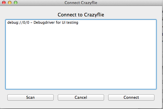

I just got my crazyflie a couple of weeks ago and very excited to get developing with it. I'm on MACOSX and have installed all the dependencies using the instructions provided, but cannot see the radio uri after scanning in the cflclient? I was using a virtualenv at first and also installed all dependencies globally and no dice. I am now trying on a 2008 mac after trying with my new 2012 with usb3.0 where the two lights on the crazyradio would not turn off. The lights turn off after about half a second on the older machine so it appears to be working. I haven't tried the VM yet, so that my be an option. How can I check if its enumerated? I looked in System Information under USB, but didn't see anything pop up when I plugged in the crazyradio. Any guidance on a next step would be appreciated.

I'm running OSX 10.7.5. Actually I just looked in System Information and it does show up.
Then I boot up the cfclient and its still not in the list? Any ideas?
I will try the VM as well.

I got everything working and now I see what the problem was. You have to turn the crazyflie on to see the radio://09/250 or radio://10/250. Silly me.... :roll:
