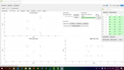

I managed to get the LPS up and running. Please see the image in attachment for my setup. Note that the 7, 2 and 6, 3 couples are quite closed to each other (about 1.9m).

There's a few things in my observation:
1. The blue dot never stands still even though the quadcopter is standing on the table. For example the x would goes from 1.88 to 1.90 continuously.
2. When I fly 4 quadcopters at the same time using swarmSequence.py script, the quadcopters look quite unstable. Please see the video at the link.
https://youtu.be/tZppOWcdR4M
I expect the quadcopters to go up and stand then go down and land without swinging around themselves like that. What's the factor should I look at?

Hey mnguyen,
the 2 cm variation is normal (atleast its also present with other drones). This is due to up to 10 cm accurate distance readings from the sensors.
As for the degraded performance with multiple drones: Are you using TWR (two way ranging?) or TDoA (Time difference of arrival)?. If you are using TWR the performance will drop as each drone will have to respond to all the anchors, because of all these packets the localisation will be slower and might cause these kind of issues. You should try switching to TDoA using this page: https://www.bitcraze.io/getting-started ... m/#intro26

Hi Yoyasp,
Thanks for your response. I'm actually using TDoA (as you can see in the picture). Have you checked the video? Is it supposed to be better? If yes then I have to find another location for more testing.

Re: Keeping the quadcopters stand still in the air
Post by tobias » Mon Feb 18, 2019 3:20 pm
Judging from the video the performance should be a bit better then that. Some movement (z is the worst) is to be expected. Airflow can actually be one of the disturbances since it is quite a small place. If you have the possibility to use another location that would be the first thing to try.
