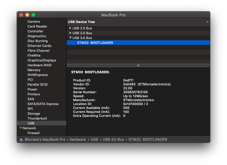

Are you sure your cable is working for data? (for example usb cables shipped with USB batteries usually do not have the data lines cabled...).
For reference, I tried on our dev mac and without battery, I press the button, connect the USB cable and release the button when the LED blinks fast, I get the bootloader to appear in the system report:

I tried with a new data cable today. I do not see any bootloader appear in my system report. Any ideas?
cboustead
- Posts: 11
- Joined: Tue Feb 05, 2019 9:33 pm
Re: Crazyflie Bootloader Flasing: No DFU cable USB device available
Hold on, it's working! The "without battery" was the most important part for your comment. Thanks
