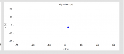

I'm setting up the loco positioning system, and I believe I've followed all the instructions:
- I updated the firmware of the crazyflie 2.0
- I updated the firmware for each of the individual nodes in DFU mode, as well as set them to the correct ids [0-7].
- I arranged my 8 nodes as shown in the set up documentation

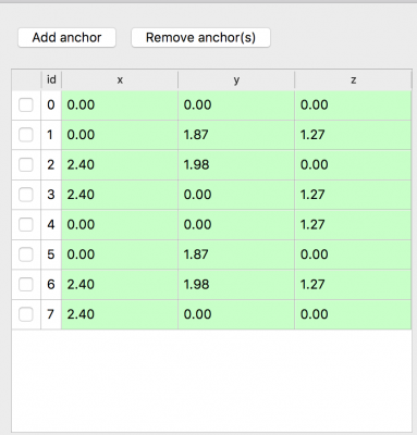

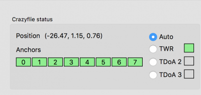

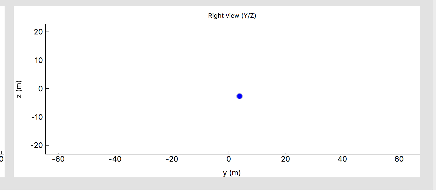

When I connect to the client (I believe I have the latest version on my mac, but unsure how to confirm), I see the green boxes appear in TWR mode, but I don't see the boxes in the graph, and I can not use the "get from anchors" button as nothing happens.
I've also included some images as attachments to this post. Please help!
