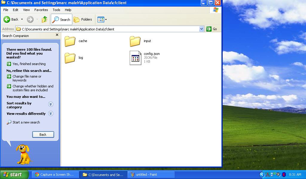

Thanks for that info. I dont seem to have that exact folder path but have
C:\Documents and Settings\user\Application Data\cfclient
see attached.
Thanks again.
see attached.
Thanks again.
foosel
- Posts: 175
- Joined: Sat Feb 02, 2013 9:59 pm
- Location: Obertshausen, Germany
- Contact:
Re: PS3 Controller Windows XP SP3
That's the one.

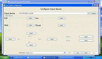

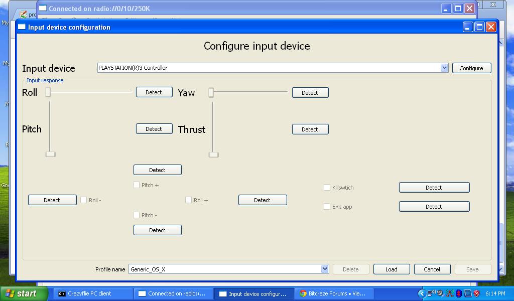

If you click on "Input Device" > "Configure device mapping" and there select your controller and click "Configure", can you assign yaw, thrust etc. to the sticks?
mfunk1000
- Posts: 9
- Joined: Wed Jun 05, 2013 11:21 am
When I do that the values don't change at all. It just tells me to move the stick or push a button with no results.

Press the round "Playstation" button in the middle of the controller and then try it again.
mfunk1000
- Posts: 9
Yup tried that earlier and got nothing.
Any other ideas?
Any other ideas?
marcus
- Posts: 659
- Contact:
So if you press "Detect" in the dialogue you are now for the thrust and push the right analog stick all the way to the top it doesn't work even after pressing the "Playstation" button?
