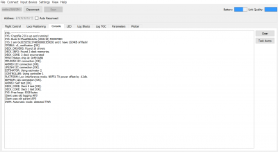

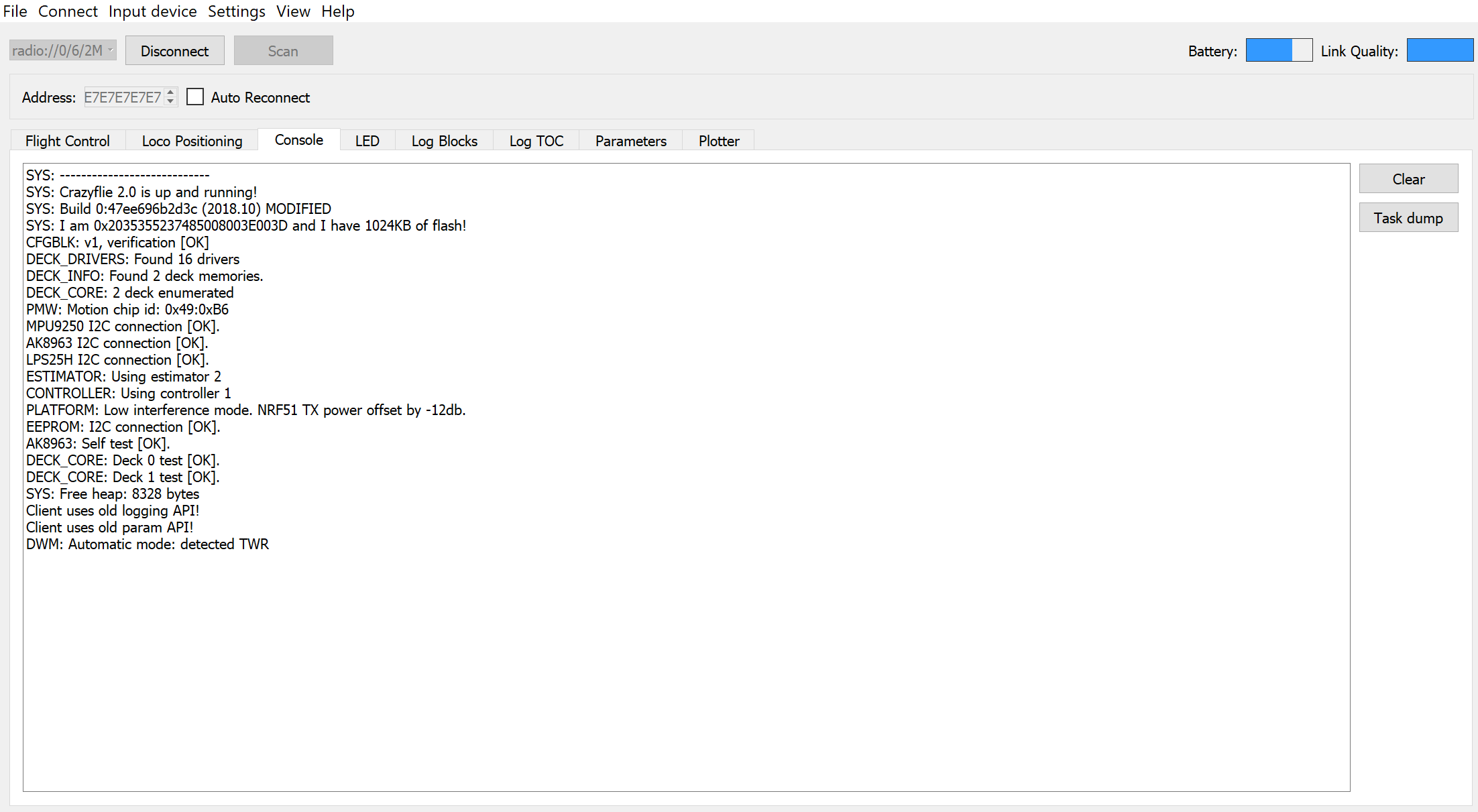

Hi Arnaud,
I am using in TWR mode. I have attached the screenshot of client console.
Posts: 2538
Re: LOCO deck - no light
Post by arnaud »
Thanks for the confirmation! TDoA and flow works well so this seems to be a software bug, either with the way the SPI port is shared or because the TWR state machine gets stuck somewhere. We will test on our side and update the thread if we find anything, in the mean time you can try switching your system in TDoA mode, since you are using the flow the geometry of the system should not matter too much, TDoA should work pretty well.
