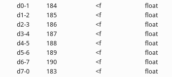

tdoa data of Crazyflie
I want to fetch the distance of crazyflie to each loco anchor. Under the log configures, I saw there is an tdoa set and under tdoa there are some data like d0-1,d1-2, I was wondering what that data stands for.

The TDoA log data is a bit messy, sorry about that. It is unfortunately not possible to get a measurement of the distance from the CF to an anchor in TDoA, what you can get is the difference in distance to two anchors (see https://wiki.bitcraze.io/doc:lps:tdoa:principles).
You can calculate the estimated distance by using the estimated postiion (in log vars stateEstimate.x, y and z) and the known anchor position.
It is probably a good idea to describe the tdoa logging data anyway.
There are two sets of logging data, one for TDoA2 and one for TDoA3. I will try to outline the behaviour but the best source for details is the source code

The log data available:
- tdoa.d0-1: The difference in distance to anchor 0 VS anchor 1, in meters. A positive value means that you are closer to A0 than A1
- tdoa.d1-2: For A1 VS A2 and so on
- tdoa.cc0: Clock correction of A0 VS clock in the CF
- tdoa.cc1: Clock correction for A1 and so on
- tdoa.dist0-1: The Time Of Flight between anchor 0 and 1, measured by A1.
- tdoa.dist1-2: The Time Of Flight between anchor 1 and 2, measured by A2 and so on
