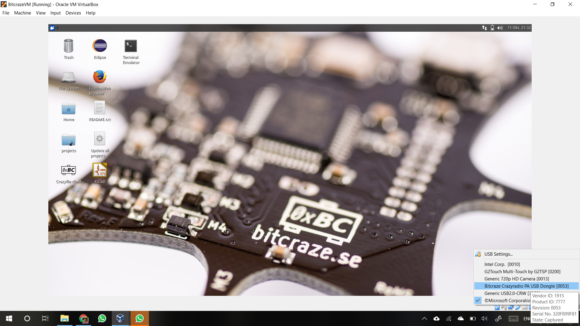

However, when I open the VM on Virtualbox, things no longer work as suggested by the tutorials. With the Crazyradio PA connected, I click the USB icon on the bottom right of the VM screen and try to select the Crazyradio PA to no avail.

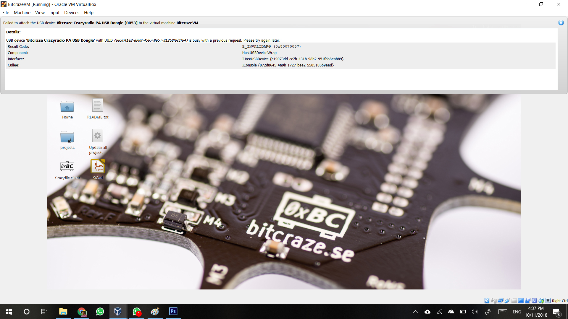

I get the following message:

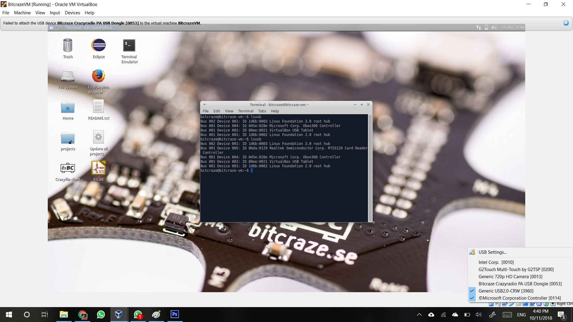

When I run
lsusb
the Crazyradio doesn't show. It is only when I select the Generic USB2.0-CRW in the USB list on the bottom right of the VM screen that I find something, though it doesn't really resolve the issue.

Re: Crazyradio PA is busy with a previous request on VM
To me it sounds like something in windows is still using the Crazyradio PA. Could that be it?

Good call.
Indeed restarting the computer and opening the VM before anything else allowed the VM to connect to the Crazyradio PA. Thanks for the suggestion.
