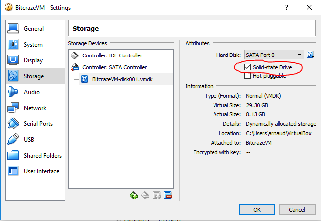

Since the error is about "DISCARD" that is usually related to SSD drive, you can try to disable the SSD checkbox in the VM configuration:
Please tell us if it works, if so we should have that disabled by default when creating the next VM.
