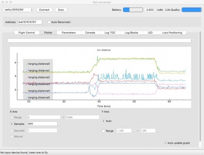

Hi again,
We have switched the system mode to TWR and conducted some tests. In the videos above, we placed crazyflie in the pre-measured points in the arena, and look for the overall estimated position of cf in addition to distance to every node. Firstly, here are the videos:

After, one of us picked the crazyflie and hold it around 1.2 meters, started from the center of the arena, and then walked to Node 0, Node 7, Node 2, Node 5 and finally to Node 0 again. The video of showing the distances to each node is here:
https://www.youtube.com/watch?v=OQNPLdQhHAE Approach to node 0-7-2-5-0
To comment, measurements are neither accurate, nor precise. For example, in video 1 where we placed the cf in (0.5;0.0;0.0), the estimated value is around (0.1;-0.4;0.3), also deviating as hell. This situation is not changing except the middle region of arena, yet, its performance and accuracy in the middle are still not satisfying. In the videos, you can see estimated values for each point.
For the "approach to nodes" trials, I can say the graphs reflect the general behavior, but again, I can't say they are accurate.
We have double checked the positions of the nodes and how we write this values to system. They are correct, as possible as we can.
We also checked the propellers for any imbalance, they all seem fine. Here you can see position hold with same gamepad, somehow its x-y performance is not bad but this time, its going up by itself, without any input.

Some interesting thing I realized while testing is that, the region you can see in the picture (saying "no battery here")(https://ibb.co/jbTZHK), is significantly effecting the performance. When battery take place in that region, performance is going bad and even it loses connection to some nodes (meaning they are turning red in cfclient), when its place is appropriate, we do not face this situation.
I have some doubts about the shape of our whole arena. As you can see from the values (https://ibb.co/j00gxK) (please do not regard the picture itself, I have just modified the original picture for sake of convenience), its not a perfect rectangle, rather it is like a generic polygon. Is it a problem, should nodes face each other perfectly? Can I ask you to look at the values by knowing that our origin is placed just below the Node 0, (its coordinates are written as (0.0;0.0;0.15), and tell me if this situation is problematic for either TWR or TDoA?

A shortish answer, we are buzzy preparing for IROS...
From your videos it looks like measurements to some anchors becomes noisy when they are "far" away. My guess is that the size of your
system is on the edge of the reach of the system (with the current settings).
There are two solutions for this:
1. Make the system smaller. At least it can be an interesting experiment to figure out if this is really the problem.
2. Increase the radio transmit power of the anchors. This works for TDoA but not TWR. Please see viewtopic.php?f=16&t=3105 for more info
bit faster if you place the copter closer to that point when starting up. We usually put (0, 0, 0) somewhere in the center of the floor.
Re: LPS System - Altitude Hold (z-position) Problem
I also have the same problem. The x and y position seems correct, but the z position is totally wrong. I have not solved it yet. Did you solve this problem now?
Thanks in advance,
Thanks in advance,
This is a pretty old thread, but we are currently discussing this on this github issue. Please provide some plots as well, to better specify how wrong the z axis is (is it a bias or all over the place).
