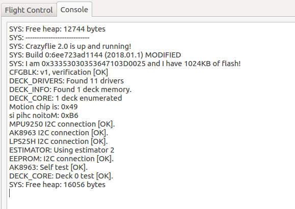

The first things to check is if the flow deck is detected and initialized. If you connect your Crazyflie using the python client you should a line with "Motion chip is" in the console tab:

I have the same issue. I have the Windows CF client; there is no mention of a 'Motion chip' in the console window. However, the artificial horizon responds perfectly when moving the Crazyflie around by hand. Unfortunately, when you try to control it with an XBox controller, it will drift or spin in seemingly random directions if you simply apply thrust. I've checked my propellers and they are properly attached in a pattern of alternating clockwise and counter-clockwise blades.

@ssedlmayr Can you copy the output from the Crazyflie console at startup?
