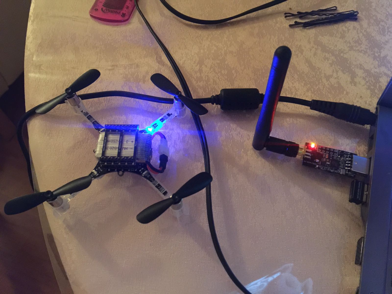

I am trying to complete my Crazyflie setup, but I couldn't solve the error below on the second image,
My crazyflie and crazyradio looks like in the first image below
any help appreciated,
Thanks,
Ayshine

Is the M2 LED blinking?
Do you start the bootloader by pressing the power button until the M2 LED blinks? If things work well, when you release the button both M2 and M3 should blink.

arnaud wrote: ↑Wed Aug 29, 2018 7:33 am Is the M2 LED blinking?
Yes, I start the bootloader by pressing the power button until only one blue led blinks (M2) when I let go only M2 continues blinking nothing happens to M3.
But, I also broke the on/off switch of the crazyflie, I think I need a new Crazyflie 2.0 control board :) Sending an email now.
Thanks,
Ayshine

Lets fix the button and the bootloader at the same time then :).
