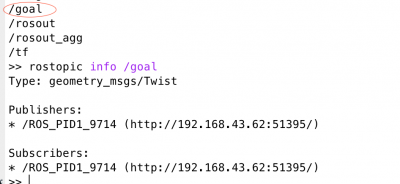

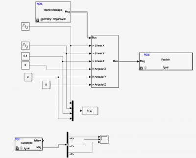

2) I created the publishers and subscribers in a Simulink file and everything works fine because in the graphs I can see the sine wave and the other command. The image below shows the model in Simulink. My question is: how can I let the crazyflie fly? Because even though I publish the topic and it appears in the list, nothing happen to the drone. What am I missing?
Should I rewrite the controller class in the crazyflie ros package?

If your controller is a position controller (and you want to use the on-board attitude controller), you can publish your target values to the cmd_vel topic. One example of such approach is the crazyflie_controller package in the crazyflie_ros stack.
If you want to replace the complete controller, the latency will be too high to run it off-board and achieve satisfactory performance. In this case, you should re-write your controller in C and include it in the firmware. One example of such approach is controller_mellinger.c in the firmware.
