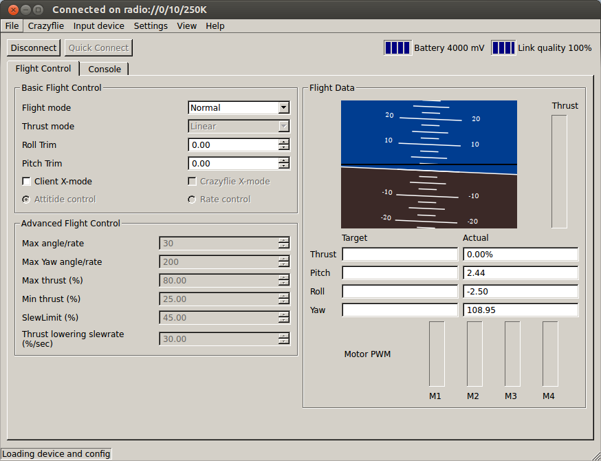

my crazyflie seems to be a bit crazy. I would actually think that it's a faulty acceletometer or magnetometer, but I am not sure.
The evidence: crazyflie is sitting on a relatively flat surface (a table), thrust = 0%, pitch and roll have reasonable values (<3 by abs value) but jaw is constantly growing in the absolute value. Its value can reach as high as 100 in just about 5 minutes (see the attached screenshot)

This is unfortunately something that all MEMS gyros have problems with. Since the gyro measures rotational rate, the values are integrated to give an absolute position. So small errors in rate will accumulate to big errors in absolute angle over time. The reason that roll/pitch doesn't drift over time is that the readings from the gyro is corrected using the reading from the accelerometer (which doesn't drift over time). The correction with the accelerometer only works with roll/pitch, not with yaw. So the yaw readings are never corrected by anything and will then drift over time. The plan is to use the magnetometer to do this correction in the future, but we haven't gotten that far yet.
As for the failing self-test for the magnetometer I'm not sure how much of a problem it is, it's not that much off. The readings will be affected by magnetic fields around in the room. If you have a laptop, could you try it outside and see if you still get the failing readings?

I did not realize that yaw is the integral value (my guess was a rotational speed). This is clearly a newbie mistake. Sorry about that.
